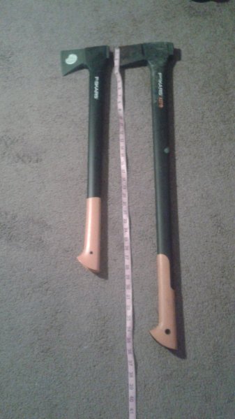

    here you go, side by side. The 36 inch is noticeably heavier, probably twice as heavy,I bought it a few years ago 20141116_193011.jpg . The 28 inch was my dad's, it's 20 years old, he didn't use it much.

    Nice. I had no idea fiskars was making these 20 years back. Ya learn somethin new everyday :D

    my 25 and 27 were almost the same sized head, maybe a 1/2 a pound difference, if that. not noticeably heavier. thought they were the same head to be honest
    edit, yup heads are same weight. your 20 year old fiskars must have a bigger head... that would be nice for the bigger rounds....
    x25 head is 4lbs total weight is 5.2 lbs, http://rockymountainbushcraft.blogspot.com/2012/02/review-fiskars-x25-splitting-axe.html
    X27 head is 4lbs, total weight is 6.4 lbs http://www.groworganic.com/fiskars-axe-36.html
    edit again, are you sure that isn't an X17? X17 have a 23" handle and a smaller head. your 25 has a different head than my 25...... the 17 and 15 have the same head, just different handles.

    No, not sure. The shorter one is the 20 year old axe, and is noticeably lighter. I don't know what it actually is, it is not clearly marked as is the larger. The X27 measures 36" from top to bottom, I assume the other is the X25 by the same measurement.

    I think that "x25" in that pic is actually the older super splitter axe, or whatever came before that. You can tell because the heads are different like freakin pointed out

    I see.. I betcha your short one is an X17. its longer than my x15. Think mine was labeled as a chopping axe? the X17 uses the X15 sized head on the longer X25 handle..notice the head difference between #2 and #3 in my pic. #3 is a 25 and #4 is the same as your 27.
