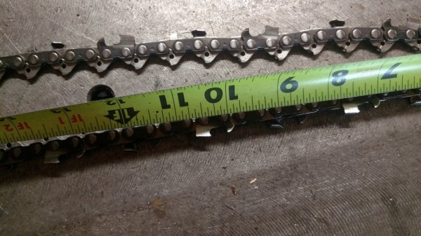

What size files do I need for my chain?

    Like Erik said there are different ones for each chain size. I have the .325 and the 3/8LP files. Bring saw with you if you aren’t sure. Sounds like you need the 3/8 non LP. It’s marked right on the package what chain it fits.

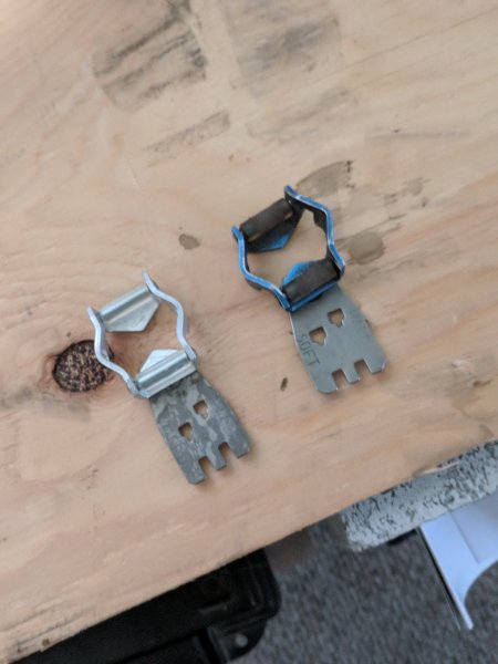

    As I understand it, the files in the 2 in 1 can be changed out when worn, but you can't change to a different size file.

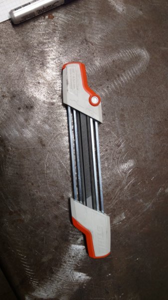

    I'll just take a picture of it, that should clear it up

    That is the case. The measurements are different for each size chain. I had to buy one for each size I have. Changing the files out is very easy and takes seconds. Mine have payed for themselves many times over.

    It looks like the regular 3/8 2 in 1 would work for you. Our local ACE hardware is carrying them and you should be able to get one from a Stihl dealer as well. I have found after you sharpen a chain 7 times, you are money ahead from taking it in for someone else to sharpen it for you.

    Thank you Erik B that's what I thought it was but I would rather ask the experts and be right than not ask and ruin my chains. Looks like this new dog is going to learn the old tricks

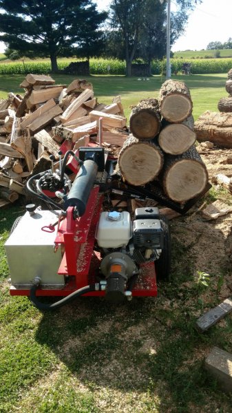

    Picked up the Stihl version today, touched up an already pretty sharp chain, and it seemed to cut a little better, wellw see what happens after a good bit of use .Thanks again everyone! Bonus picture of the wood splitter in action with newly welded on log lift!
