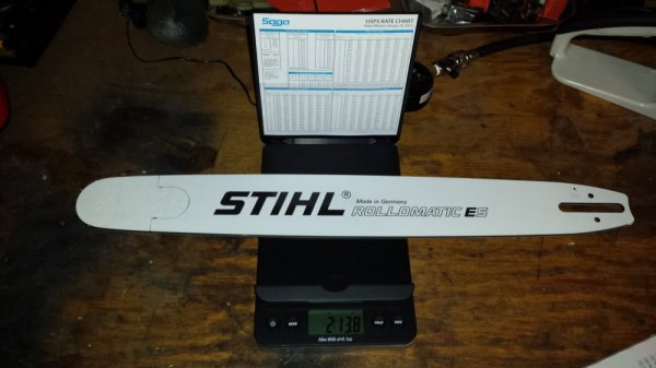

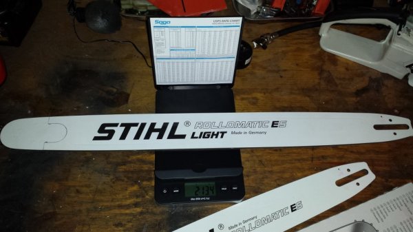

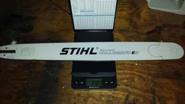

    What's the weight difference of a 20" bar and a loop of chain versus 16"? I know you guys got scales out there....

    I don't have a 16" ES, but a 20" is 2 lbs 13.8 oz.
    And the 25" (same as Husq 24"/84 DL) is 3 lbs 10.7 oz.
    And the 28" ES Light is lighter than the 20" at an astonishing 2 lbs 13.4 oz.
    If you take the 4" difference off the 25/24" to the 20", and deduct a few oz for the chain, it's about 1 lb lighter. :)

    Also if you use an E bar instead of an ES you would lose even more weight. Don't forget that the laws of physics say that shortening the bar will reduce the weight "felt" by the operator at the handle, even if the weight of the longer bar is the same as the short one.
