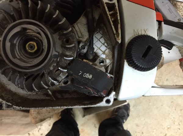

  18. cgraham1
    cgraham1
    Sep 3, 2014
    840
    3,210
    Nor Cal
    Is this where the coil's supposed to be? :eek:
    Pay no attention to that big chunk missing from the case...
    clemsonfor and cnice_37 like this.
  19. david young
    david young
    Oct 8, 2014
    64
    129
    Joey,
    I had good luck with that mod, seemed like it was enough. I did one by knocking the ridge off the lowers. lowered the intake 4 degrees left the uppers and exhaust alone. saw ran very well for how little I did to it.
    I've been using lock washers on the muffler bolts with good luck so far. couple different saws.
    how did you find the airleak on the transfer cover?
  20. Cut4fun
    Cut4fun
    Mar 18, 2014
    1,941
    3,571
    OHIO Redneck
    Spraying carb cleaner would probably find that leak?
