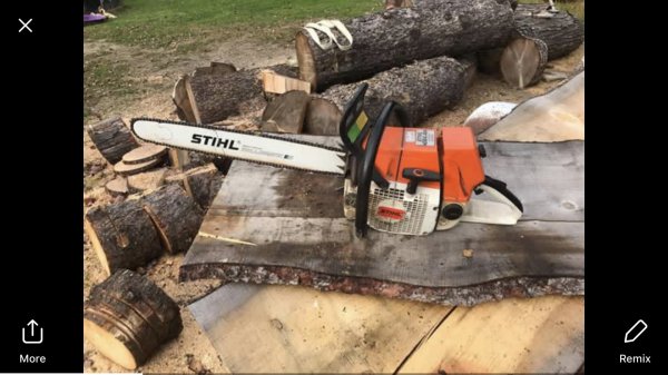

    F0AF58D5-737D-405B-9547-F364501CDAE2.jpeg 5619E5C8-3204-458F-8874-66F5ADFAD1F4.png 46AEA8E4-4BA0-4810-9F85-DF0F57E120A9.jpeg
    few of my big wood/milling saws. I still have the 075,090 and 066. I sold the 064 2-3 years ago but have stuff to build another also have added a basket case 076 super.
