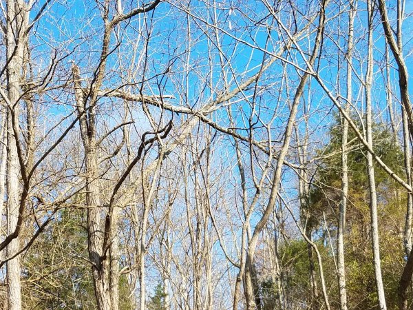

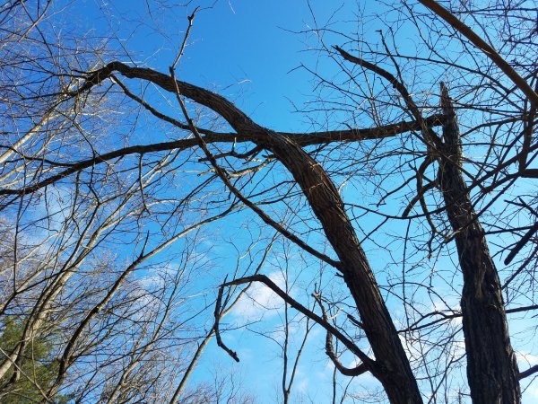

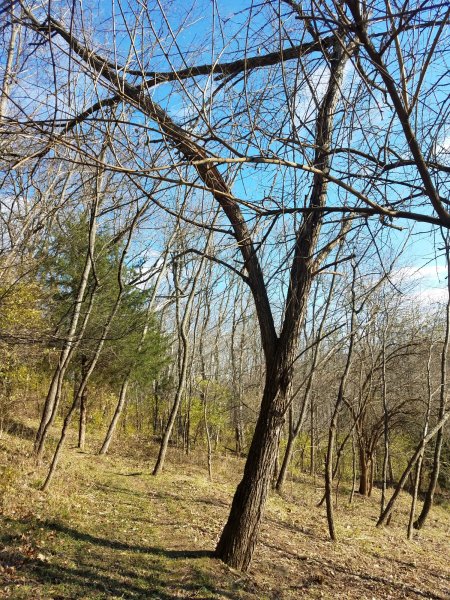

    Rope will be something from the horse farm where I work.
    More pictures:

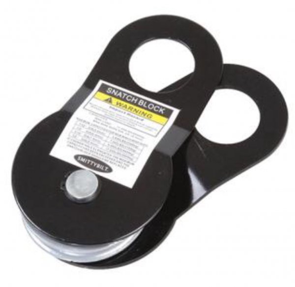

    I have one of these in my inventory so I can pull with my truck (or other appropriate pulling device) in a safe direction while pulling the tree to where I want it to go. Use a 30' tow strap at the anchor point which allows me to vary the length depending on the number of wraps I take around the tree that I use as the anchor. May or may not help in your situation.

    It looks like it has a good lean to it. I would probably just fall it the way it leans. As long as you have a good escape path and can run !
    There's a line in a song by Craig and Terry, " like when to take your time , and when to cut and Run.

    From the pics, it looks like the main trunk has some conks on it , and a couple cat's faces.
    What ever you do with it , make sure your wearing your hard hat or helmet. !!!!!!!!!!!!
