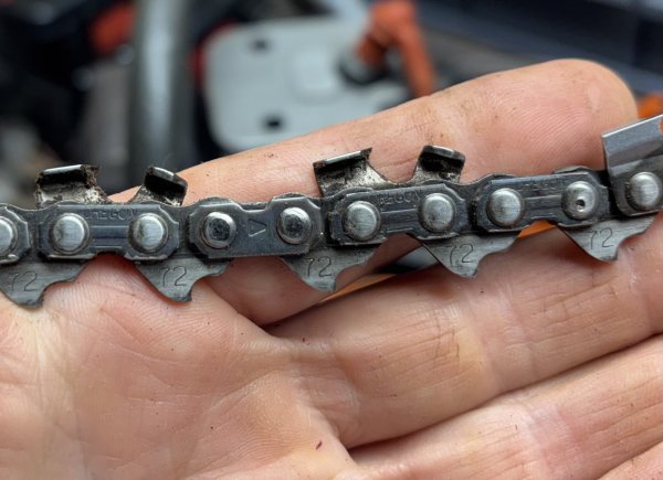

    The folded portion can easily be ground off and it will perform much better.
  2. Eric Wanderweg
    8,649
    68,673
    Yessir, that’s SOP for me once it’s time to sharpen them. I grind the extra width off and also thin the front of the raker to reduce weight further. It’ll never make good race chain but anything that I can do to reduce drag/mass will help.

    Seems clamping in a vice and using a grinder would do the trick too? Seems I remember having a chain like that in the past and gave it to one son to use as a stump chain,don’t think I ever ran it.

    One of the guys on the saw forums (Cole) made a very very fast chain outta that. Never say never.. He posted a vid of it but I can't seem to find it. Let me keep looking (for schlits and giggles).

    Wow... I can believe that. I was running one of my 18" Vanguards on my 61 last month, square ground with low filed rakers. Even cutting black locust I was impressed with how fast I was ripping through logs with it. That's why I keep scarfing it up when I find good deals on it; most people don't want to fool with it and yet it works just fine for me.

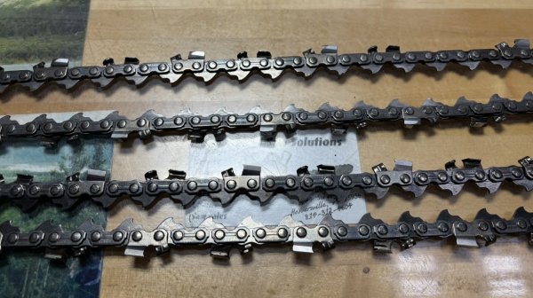

    I bought a batch of four used 0.375 x 0.050 chains from eBay recently and two of them were Vanguard style of course. The other two were semi chisel which I was actually after, for when I cut dirty black locust and the like. All of them were 70DL so either I add two links or subtract two, depending on what I need. One of these Vanguards is brand new, never used. The other one someone dulled out cutting asphalt I’m assuming, then kept going. I probably will put that aside to save for a stumping chain when I feel like grinding most of the teeth away.
