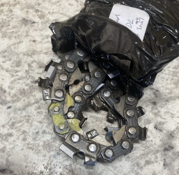

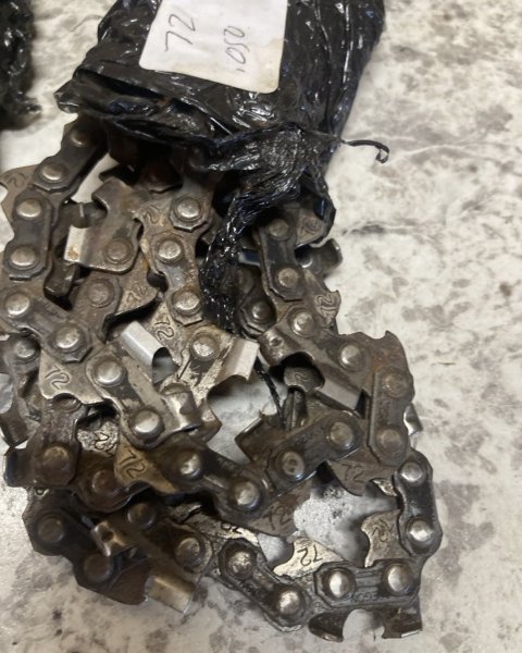

    Two extra chains came with my used 400 when I bought it last month. Was going to put one to use on the next cutting and on further inspection...weird rakers? I've never seen any like this. Its an Oregon brand. Is it some type of safety chain? DSCF0901.JPG DSCF0904.JPG

    That's the Vanguard I was telling you about. Safety chain. I have a few loops. Works fine but the raker is a PITA to take down.

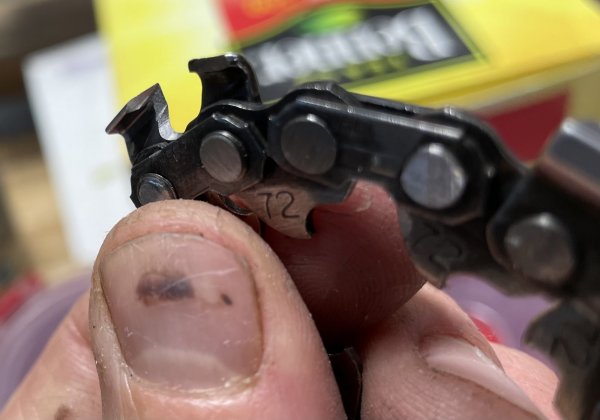

    It probably won't :whistle: IIRC files either skip off, or get trashed quickly. On my Vanguard loops I grind the rakers so it's a non-issue. I also grind most of the extra material completely off too. That's a lot of extra weight that the saw has to pull through the cut.

    It's about a 10 minute job standing at a bench grinder, or a 1 minute job followed by a flying chain and profanity when you grind the tip of your finger :whistle:

    Not that I've noticed, and I've used my Vanguard loops a lot the last couple years on my 18" bar set ups. It performs just fine, and I've even bore cut with it. As far as longevity goes, it's a middle of the road chain IME.
    The first one I acquired came with the Husqvarna 61 that used to belong to my grandfather. You can see here how I thinned the raker considerably. I used that chain to practice square filing before I bought the jig to grind square chain. I still have this chain, although it's been relegated to dirty work as it's quickly running out of useable tooth length by now.
