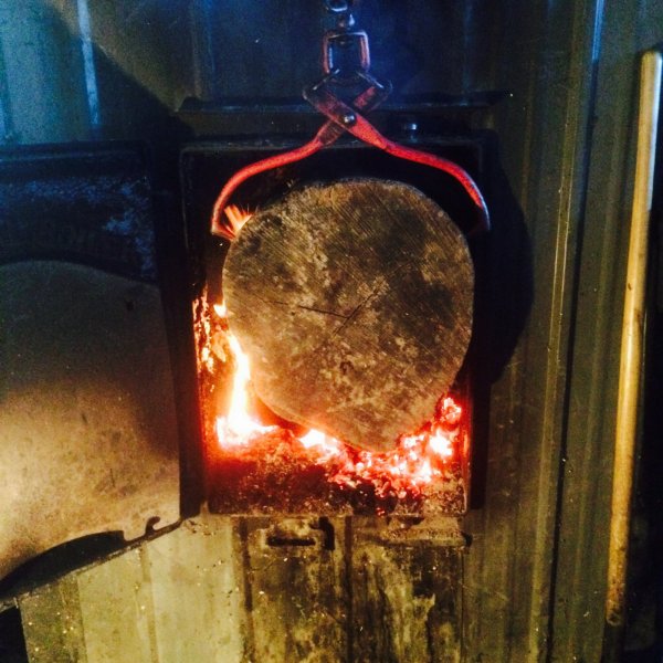

    Looking for some help/information. I’ve been using my 6048 since new for 12 years now. For some reason this fall I’m having a hard time getting a fire started to catch when reloading. Flames up & burns great when I load it but once I close the door it’s seems to struggle to catch/ignite. This was never an issue before & I’m probably burning some of the driest wood ive had in quite a few years. The other day during a warm up I let the fire go out, cleaned out fire box, scraped the inside down thoroughly, inspected chimney & it was all clear. Lit a new fire & same thing. It seems like it’s not getting enough air or draft with the door closed. I have a fan on the door & it seems to be blowing fine when I put my hand on the inside of the door where the air comes out. Any ideas?

    The way my stove is operating currently I’m sure my fire would go out if I put a piece that big on the fire. That didn’t use to be the case. Something seems to have changed but I’m not sure what it is.

    Have you checked the cleanout at the bottom of stack ? What type of material is in there ?

    Nothing to speak of. That’s where I took a mirror & checked to see if it was blocked & cleaned it from but it was clear. I got very little debris from cleaning.

    Wind coming from an unusual direction when this happens?
    Like maybe up over a building ?
    A lot of ash buildup in the back under the heat/smoke dam?

    No & No. It’s puzzling

    6048 is fan induced draft not natural? I wonder about restriction on the draft side.

    Mine would go out too with just a monster in there. It's why I mix in a lot of small slabwood/lumber cutoffs.
