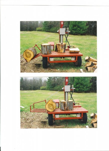

    On the vertical table style splitter the log lift can be operated by the action of the splitter ram with a simple cable and pulley.
    savemoney, Stlshrk, Hammy and 2 others like this.
  12. Stinny
    14,140
    60,689
    That would work fine with a fast-to-latch system to hold the log lift in the up position. Great idea!
