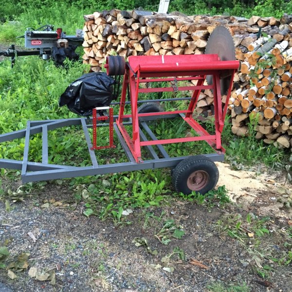

    So, just to get this back on topic, this is what I use to determine how small I cut. I use an old cordwood saw that is modified to run with a 10HP engine and is trailer mounted. I can handle 8' lengths on this for the most part and I usually cut to 2' lengths for my OWB. So when I drop a small tree I cut 8' lengths out of it until the small end gets to be around 2" or so. Same thing when I limb bigger trees; I figure 8' lengths out from where they attach to the trunk and go out until the small end will be around 2" or so. Here's the rig I use:

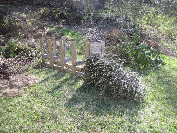

    I pretty much process the tree down to the twigs. Sometimes the pile of twigs gets thrown in the chipper, but other times I place it in a holder and cut it into 16" kindling. The holder, for lack off a better name, is made from old pallets. Note the pile of twigs at the end of the holder! Seems I posted a picture in some other thread sometime back, but here it is again.
