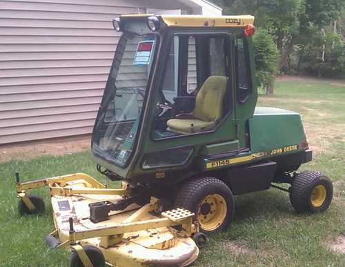

    I am at best a weekend warrior and this is why I struggle with these decisions. I've gotten lucky so far buying older machines that needed a little work that I have been able to get out of for what I paid for when I upped my game. Life is a series of compromises, so choose them wisely right?
    On a separate note, I assume it is universally agreed that a glass cab doesn't belong in the woods under any circumstances unless you have nicely graded and cleared/maintained forest roads?
