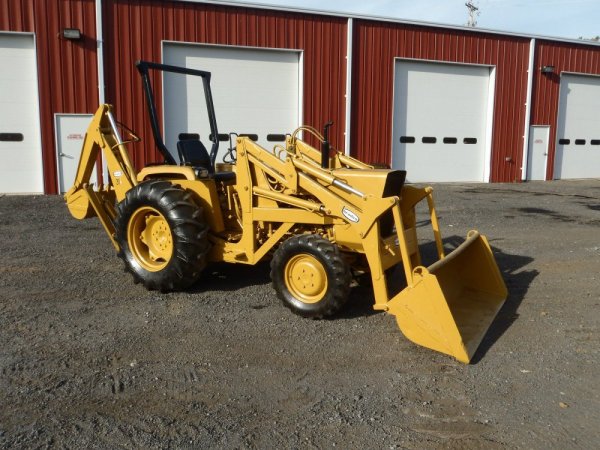

    MM, I agree and once again I'm probably trying to do too much with a one machine solution. I think the large frame CUT is similar to the Ford in size and weight and exactly what I should have at home (arguably overkill but lets not go there). I'm trying to come up with a one machine solution to go back and forth to camp. Up there, I'd like to be able to deal with granite boulders, bigger trees, etc....things that you just cant practically make more or slower passes with to get the job done. I'm probably not going to get a lot for the Ford even if I put the backhoe on it. Maybe the thing to do is get a newer more capable less maintenance requiring machine for home that I use 95% of the time. Then, if the Ford can't do a particular job at camp, it doesn't get done unless it is worth it to rent something.

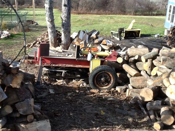

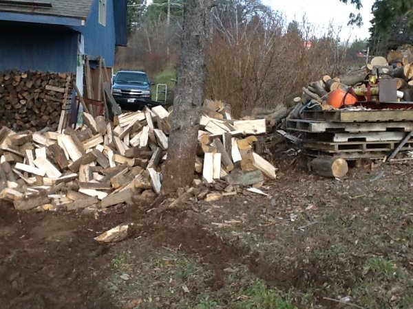

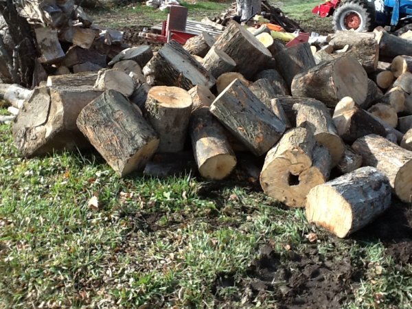

    Yesterday was another pretty good example of what I use the Ford for around the house. I had split everything within easy reach of the splitter and had started walking for rounds and ran out of easy toss room for the splits. 10 mins later, I had the exit cleared and a pile of rounds within easy reach of the splitter. Given the layout of my property (the only flat spots are the ones I have made), the bigger tractor probably wouldn't be of much use for stuff like this.

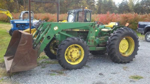

    Me too. My FIL had a 2440 with less than 1000 hours on it. If that had had a drive shaft going to the front wheels, it would have been the last tractor I owned. This 2240 on Ebay is pretty tempting but I think MM is probably right about it being too big for most of what I need a tractor for.

    Acre and a half with over 100' of vertical at home, 60 acres of rugged terrain in the Adirondacks. 2 hour tow in between that I will need to take it easy on if I go bigger. Maybe I just need the industrial version of what I have now (I broke my loader again recently). I could swap what I have now for this one, get a heavier duty higher lift loader, frame mount hoe, reverser and power steering. Probably only be out a few grand to make the switch and my rototiller, 8' rake and 6' box blade are all still relevant.

    2240 is 54 Hp I think. We had one my dad bought new in 77-78. It had ROPS so that one is likely older. Great tractor built like a tank in Germany. But it is 35ish years old. What kind of price is it?

    I think they want $14.5K for the 2240. That is a heck of a lot more tractor than the equivalent compact purchase for that kind of money.
