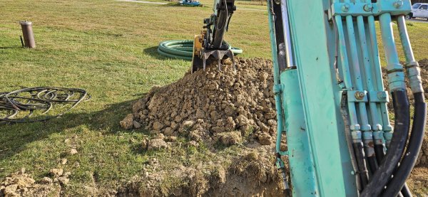

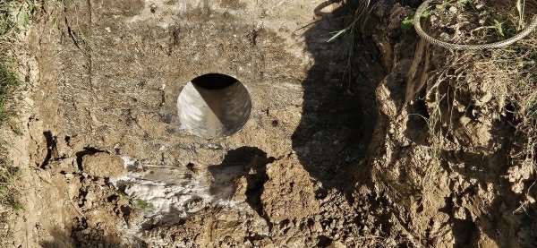

    The ground is freaking hard!
    Also, the Amazon core drill didn't work, had to go all "professional."
    walt and brenndatomu like this.

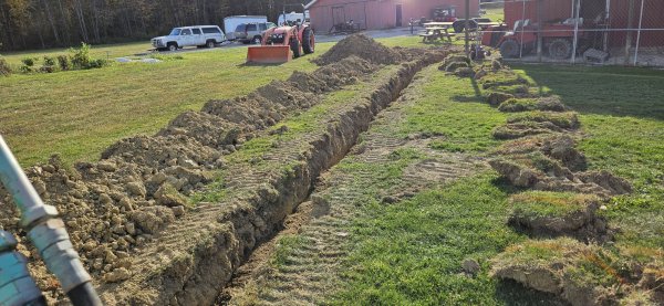

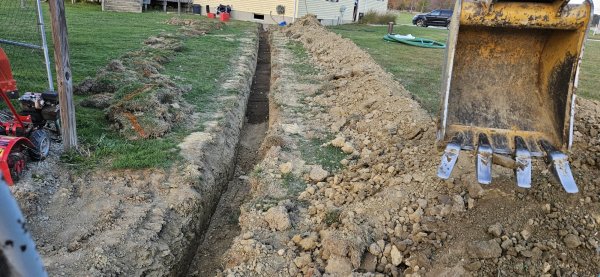

    The line is in, I must have the other pics on my GoPro.
    walt, morningwood and brenndatomu like this.
  8. brenndatomu
    25,097
    163,030
    Yes, the ground is very hard right now!
    You using a link seal in the wall, or just just hydraulic cement it shut?
    walt, Casper and Canadian border VT like this.

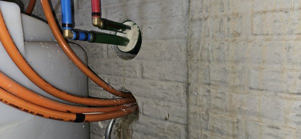

    Seal it? Uhmmmm....
    I'll post a Pic later.

    The orange lines have been there 22yrs and the only time there is a trickle of moisture is when it rains after a long dry spell and the ground has pulled away from the exterior wall. I back filled from footer drain to about 20" below grade with pea gravel. It's right about at the level where those line enter the wall, the new set are in clay'ish topsoil.
    brenndatomu likes this.
