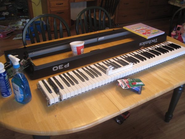

    Sorry.. Stepped away for a few to do some piano repair. The clearance to combustibles on the side of the stove is 22 inches.. I'm at 21. I hit it with the IR thermometer all the time and it's no where near hot enough. I figure I'd be most in danger of something happening if we had a really hot fire and the blower shut down thus making the stove hotter and kicking out a ton of radiant heat. But yes Sir. I will keep an eye on it..

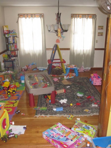

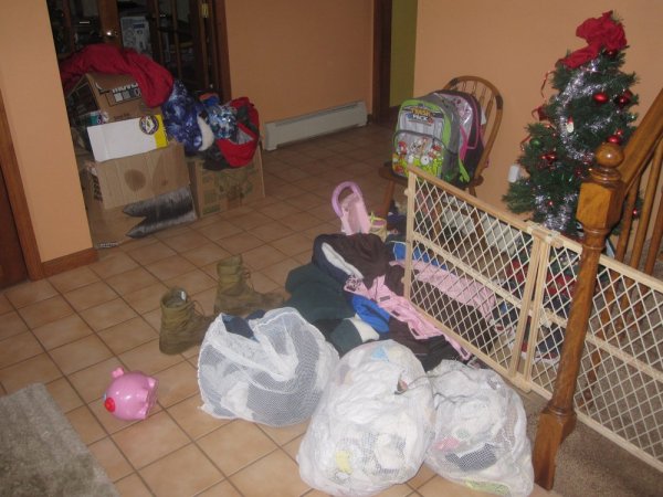

    Couple people mentioned wives would never let them do it? Well, attached are pics of the front entryway and "dining room" for comparison.. When she gets those cleaned up, I'll take down my wood stove fired kiln!!:whistle: (she's not a member here yet)
