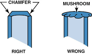

    Just make sure yall trim your wedges when they need it. Don't need no flying shrapnel.

    "trim" your wedges? I guess you mean file off any hanging edges as they get worn/ bent....?

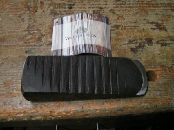

    Wetterlings Sweden forged boron steel twisted wedge about 3.75lbs

    The Helko & Mueller are pretty much identical in shape,just different weights.With their thin edge/long taper I rate them the best equally. The Wetterlings is 2nd cause its edge is thicker,I did a few minutes modification with the 4.5" angle grinder to reduce it some.Works much better now.
