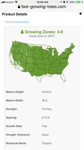

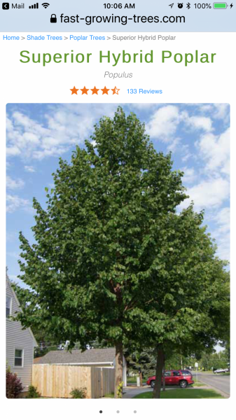

    We sell wood pellets over here in 40 lbs bags for approx $6.00 per bag that is $0.15 per lb or 15 cents per pound. :)
    Therefore your price over here at $2.00 per lb would be $80 per bag compared to our price of $6.00 per bag!! Holy Smokes what a difference!!!
    So if you could plant the fast growing Popalar Trees and harvest them to make wood pellets, could that be a money maker???
