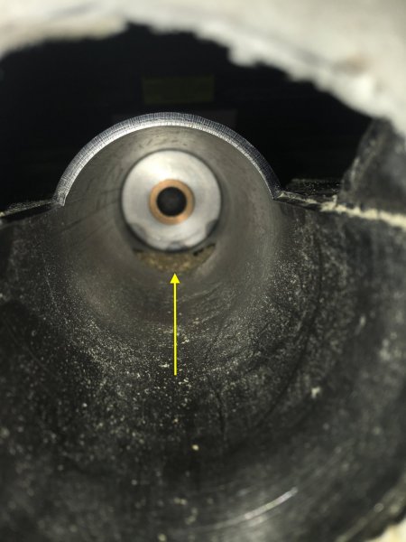

    Moisture is the biggest enemy of the pellet stove.
    These pellets were stored outside on the porch and absorded alot of moisture.
    The stove jammed and it was baled and freed, but it just jammed again. The drop chute was completely clogged with pellets and the auger kept cranking and squeezing the pellets at the top of the auger chute until the motor jammed and wore the bearings in the motor until grease started leaking out of the new motor output shaft! The auger motor was a good quality motor that had a new bronze oil lite auger bearing installed earlier in the season. The motor was damaged and the bearing was scored. If the jam and cause is corrected right away then these parts may not have been damaged so heavily. Continued use did cause the damage!
    The stove is an older St Croix York and it does have a small opening into the drop chute from the auger flight shaft. I heard this was corrected on newer stoves. However moisture in the fire box from a damp cleaning or damp inlet air or high moisture pellets can still cause this issue in many stoves.
    Therefore a new auger motor, auger end plate gasket and bearing was installed.
    Has anyone else seen this? See pics below
    Click on pic to Enlarge
    Pic 1 - Shows pellets fused together and clogging yp drop chute completely
    Pic 2 - Shows drop chute after clearing pellets by sticking a brush up drop chute in fir box

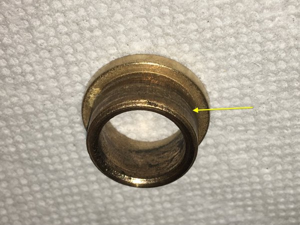

    Pic 3 - shows damaged auger motor, auger bearing and end plate gasket
    Pic 4 - shows close up for grease leaking from auger motor output shaft
    Pic 5 - shows ager bearing with small gouge rings from auger motor jamming.

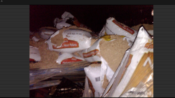

    Did you ever see water condense on the inside of your window pane or the outside of a toilet tank? No water went through the window or the toilet tank!
    If the air inside the bag of pellets condenses then the pellets can turn to mush and clump up.
    I always have a ton next to my stove so they are warn to prevent condensation,
    Here is 1 Ton of Pellets Walmart dumped into their dumpster because the pellets in the bags turned to mush!
    IHATEPROPANE likes this.
  8. IHATEPROPANE
    IHATEPROPANE
    Oct 13, 2013
    4,665
    19,050
    Those pellets that you brought it to sit nicely next to your pellet stove have been outside for the vast majority of their life. You warming them up does nothing.
    Every bag of pellets i have ever burned have been virtually vacuum sealed. No air means no condensation. Condensation happens on the outside of the bag. No effect on the pellets.
    Those walmart pellets probably sat under a rain gutter with a hole in the bag.
    There is ZERO chance that happened without direct water exposure
