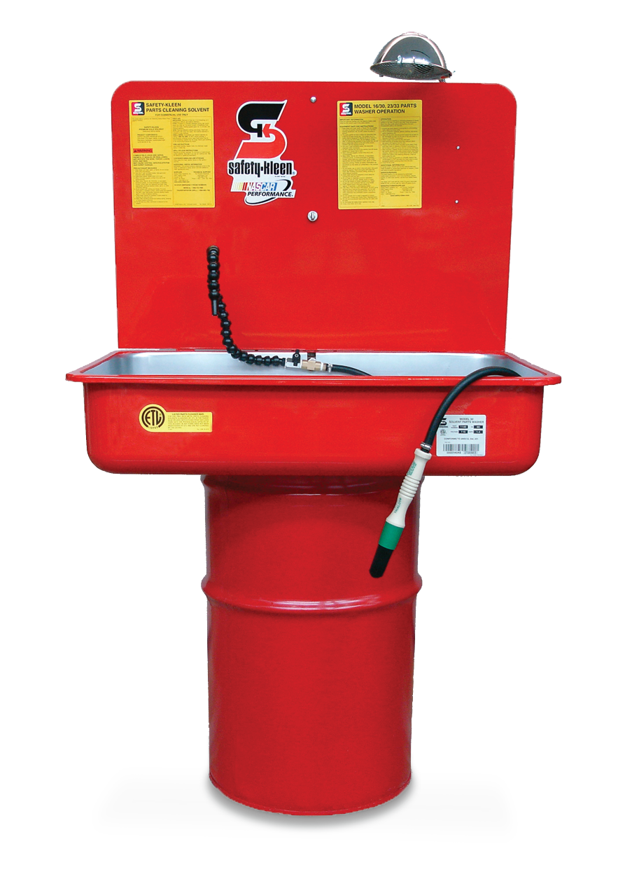

    If you can find one with the drum on the bottom you might be better off for a couple reasons.
    With the drum any sediment settles in the bottom of the drum when it sits , since the pump is off the bottom the sediment stays there.
    The other advantage with the drum is when you shut it off the fluid goes into the drum and you can leave parts in the tub to drain and dry. The one you are looking just has a little shelf to put parts on that sits above the fluid.
    Just my 2 cents.[​IMG]

    They are almost always on Craigslist around here.

    Might consider this although I'm trying not to take up space on the bench.
