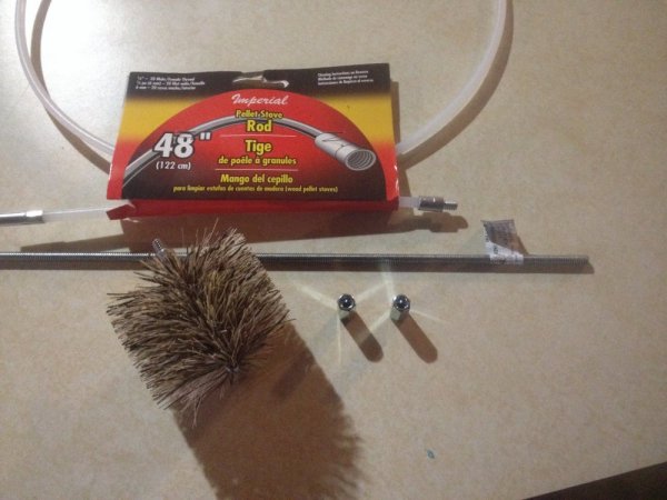

    I have 3" pipe kit I bought at lowes.
    Here is a flex-rod they sell, brush. And they told me they don't sell anything to connect them to drill with, and they don't sell a solid section of rod that would screw into these fittings.:mad:
    So I said okay. Thanks. Then went down to their hardware isle and bought these to threaded fittings and a piece of all thread.:D
    Some of the employees don't have much time or experience. LOL
    Time to get cleaning.
