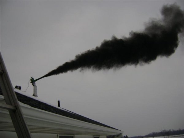

    Gas...once smoke sees this post I'm sure he'll post his LBM (leaf blower method). This is the absolute best way to clean your vent between full cleanings......period. I also have a 3" vent brush that I run through the vent before the LBM. I think lots of pigs buy the "Lint Eater" brand brush but I just have a cheapie. Oh, I typically do the LBM once or twice between a full cleaning (20-25 bags or so).

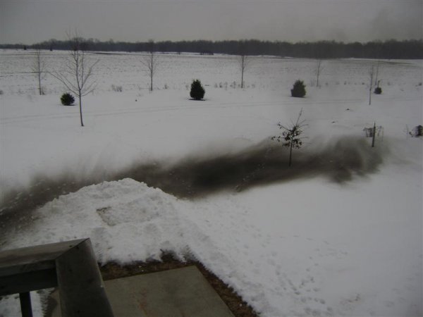

    I use a Lint eater kit, my DeWalt cordless, and a Leaf blower :)
    Here is a weak one at my dad's house.
    Another weak one at my house
    Smoke shows is pretty amazing :)

    Second pic looks like your hosting tractor pulls on your roof.
