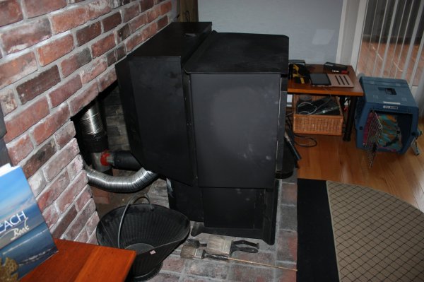

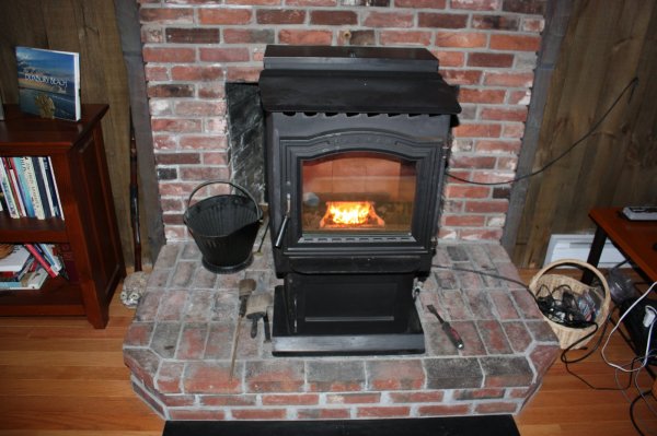

    This is my setup.Harman P68.Stainless liner to a Prairie cap on top of the chimney.Oak draws air from the top of the chimney thru an opening in the cap.
    SIZE STOCK # DESCRIPTION
    3” 3PVP-VCTB33 3” PelletVent Pro Prairie Termination Cap Black with 3”
    exhaust vent and 3” air intake
    3” 3PVP-VCT33 3” PelletVent Pro Prairie Termination Cap Stainless
    Steel with 3” exhaust vent and 3” air intake
    4” 4PVP-VCTB34 4” PelletVent Pro Prairie Termination Cap Black with 4”
    4” 4PVP-VCT34 4” PelletVent Pro Prairie Termination Cap Stainless
    Steel with 4” exhaust vent and 3” air intake

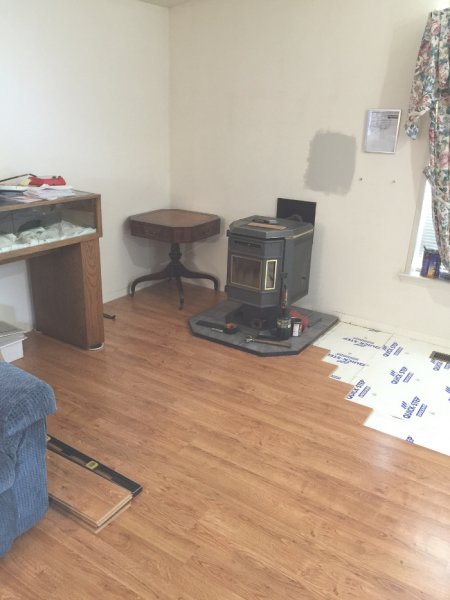

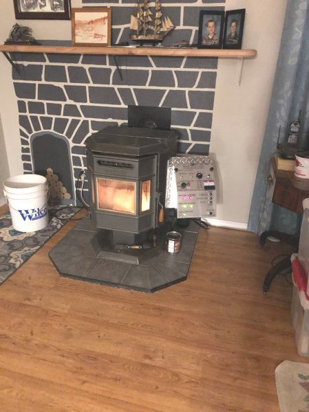

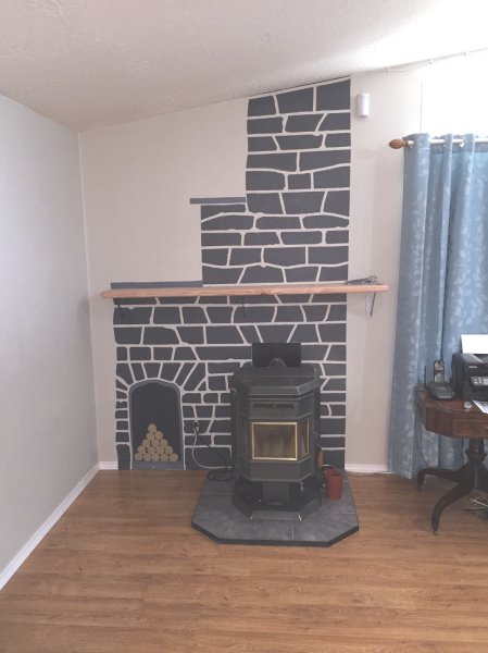

    I agree with LW on the negative aspect of modding the fireplace.
    "If it were me" I would look real hard at a corner install to the left of the fire place.
    There are some cool things that can be done very inexpensively.

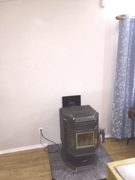

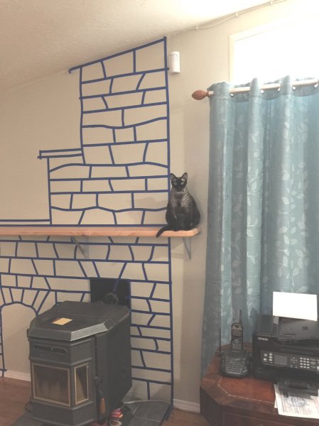

    Here is what I did for our small Whitfield install.
    The graphic work took a roll of blue masking tape, some dark rock gray paint and a bit of finesse..
    Get after that wall with a stud finder and see where the studs are....then rock and roll.
    Nice part is....in the future it would be easy to remove the stove, patch the sheet rock and it would be as though it never happened.
    Does not look like there is a window on that side either.
    My wall graphic and mantle were whipped up and laid out in a day.
    Did the paint and zooooop....done
    A little thought and clever paint work could make a corner stove install look like it is all part of the fire place....
    Duplicate the brick color to match the fire place..
    The other side has the window and the baseboard heater to fight with (bad choice)
    Just my 2 cents

    Snowy, I have to say that set up you did is very very cool. I love the simplicity and inventiveness that went into it and it looks great.

  7. Snowy Rivers
    Snowy Rivers
    Nov 15, 2015
    2,849
    12,491
    Newberg, Oregon
    Thank you.

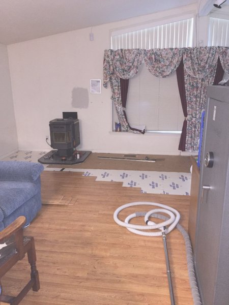

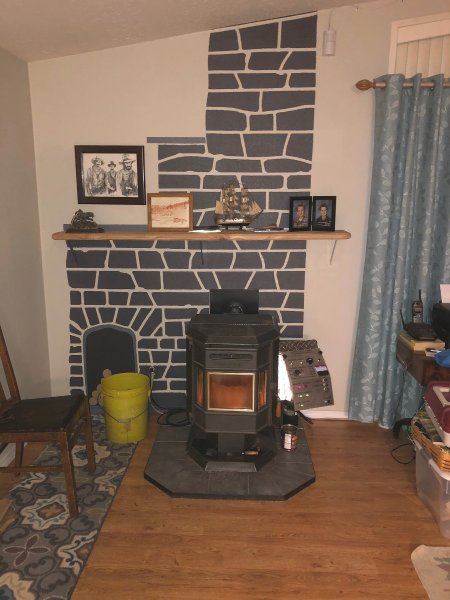

    When we remodeled things back in June of 16 it looked a lot different.
    We tore out the carpeting and laid a laminate flooring (1000 sq feet) in the dining room/living room.
    Found it on Craig's list (Used from an upscale home remodel....with all the pad for $200)
    With some creative "elbow grease" and very little $$$ one can achieve some marvelous results.
    Stove with Floor pad and pipe/thimble $200
    Flooring $200
    Paint for room and the dark gray for the graphics $50
    We added new drapes, painted the room
    Custom fabricated the drapery tubes and brackets.
    All together the complete makeover was under $1000 (Stove, floor, paint, drapes yada yada...and some Tylenol for the sore body.

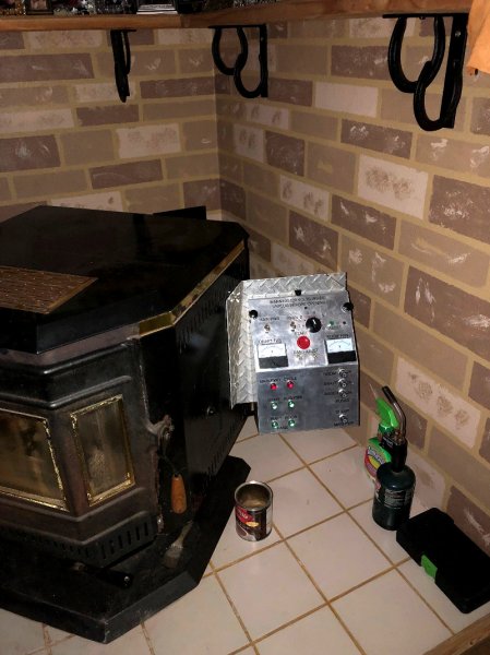

    Here is the stove today after I added the new custom controller.
    What can be achieved is endless and does not have to cost a fortune..
    Our large stove in the family room and with its new controller.
    Busy busy busy.....
