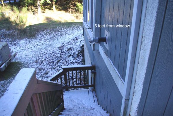

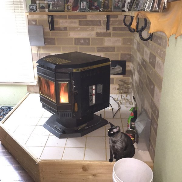

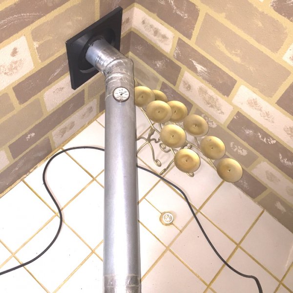

  7. Snowy Rivers
    Snowy Rivers
    Nov 15, 2015
    2,730
    11,959
    Newberg, Oregon
    If you have room to punch a hole between 2 studs and fit in the vent thimble I would definitely not Hack the fireplace.
    I am a firm believer in the "Direct vent" keeping it where you can access it easily for cleaning.
    So easy to stuff the leaf blower on the short vent and suck things out....put the 45 or other type of termination cover back on and GOOD TO GO
    Much less expensive too.
    Here is a piccy of my install on our large Whitfield... tight corner through the wall because of window trim (Fake shutters) and gutter downspouts were in the way farther toward the window....also the needed distance from the window that could open....
    As long as you don't get too crazy with the horizontal pipe length you are good to go.
    I wanted complete access around the stove to allow maintenance unhindered.
    My horizontal run is at the max of the mfg spec....but there has never been an issue.
    I do an LBT twice monthly when running 24/7
    If there is a corner ????? maybe be able to do a raised hearth or some other type of idea to give the look of incorporating the stove with the fireplace ???? just a thought.
    A lot can be done with very little $$$$$ being spent.
    A lovely used stove might not be a bad choice if you don't mind a little bit of work.
    Creativity is the key to $$$$ savings.:yes:
    Just an FYI

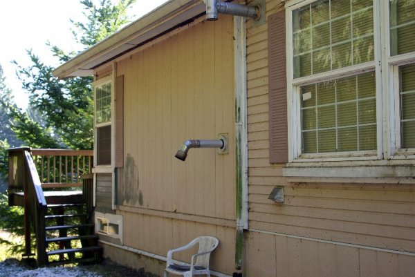

  14. Snowy Rivers
    Snowy Rivers
    Nov 15, 2015
    2,730
    11,959
    Newberg, Oregon
    Our place is a big triple wide MFG Home that is on a full daylight basement.
    1000 sq ft apartment in the basement as well as my shop and more storage.
    The basement is not connected to the upstairs as far as ingress/egress.
    We have lotssa corners and NO hallways
    Sadly several of the corners were too close to stuff that I simply could not deal with a vent hanging out the side of the house.
    Thew little stove vents above the stairwell coming up to the deck (Our main way in)
    The big stove vents out on the North side and the vent is about 5-1/2 feet off the ground.
    I bet you folks can come up with a good plan...
