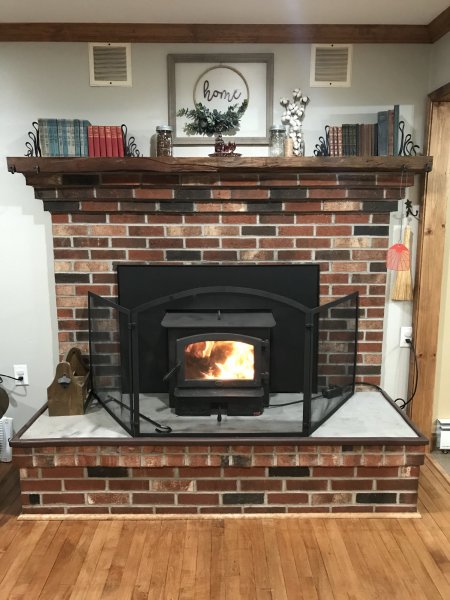

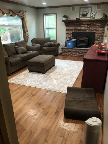

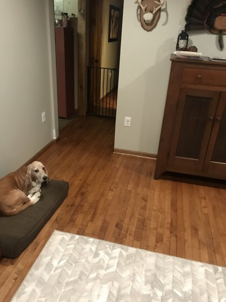

    So got sidetracked on the updates. Here’s the room almost done, just a couple finishing touches needed.... 4520E3EF-EA53-4F9C-A0B1-E895F014A5E8.jpeg 5E672CBA-36F3-4B42-ABEE-285BEBCAAD25.jpeg

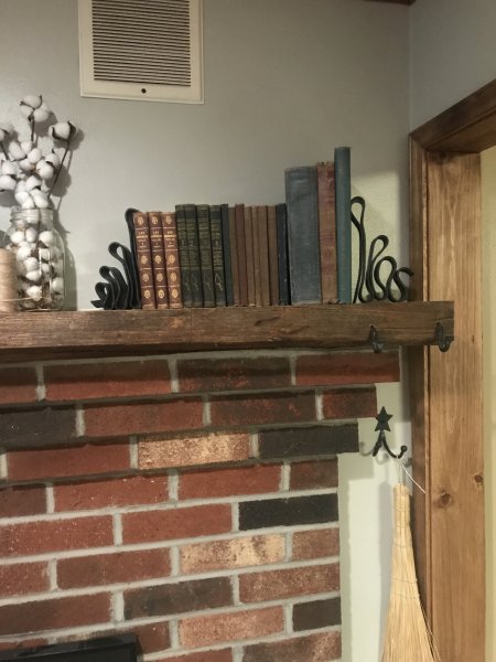

    A couple barn beam shelves with black smithed strap hangers to match the mantle. 783488FC-5586-4527-B47A-DB23E4D1B0A7.jpeg

    should have left the drill on the mantle, need that masculine touch ;) just joking

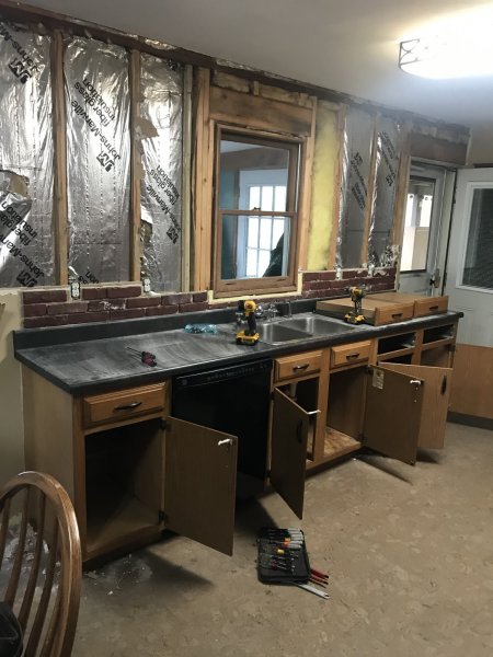

    The wall behind the sink had brick veneer all over it so easiest thing was to tear out the drywall. C3E44DC3-EA36-437C-89C5-0E249C0B7E61.jpeg

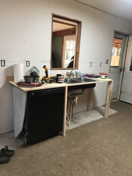

    New drywall and cabinets all removed. FFF30ECF-E6FF-46C4-BCA7-4EFC3C508DD0.jpeg

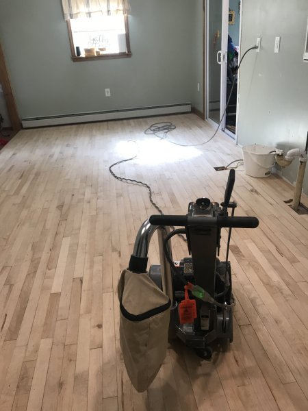

    Fresh paint all new plugs, switches, lights and of course more hardwood. Getting ready to fire up the sander this morning. A103CA6E-55C8-4592-B55A-79D35AA60B64.jpeg

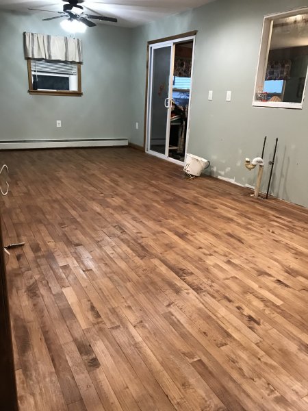

    I like the temporary sink/countertop idea...and nice work! :yes:

    Looks great, the only tip I would mention and it’s too late for you. When sheet rocking, and doing kitchen lay a full sheet between the top of the Base Cabinets and the uppers. That way you have no tape scene where all the outlets and top of the counter is. An old timer showed me that trick

    Wish I’d have thought of that!! That darn seam ran right across all the 5 boxes smack dab down the space where there’s no cabinets. I’m thinking some stone tile is going to be going in there though.

    why it’s a great trick.. taping and feathering around boxes suck.. also lower and upper seams behind cabinets.. still tape them but less of perfectionist
