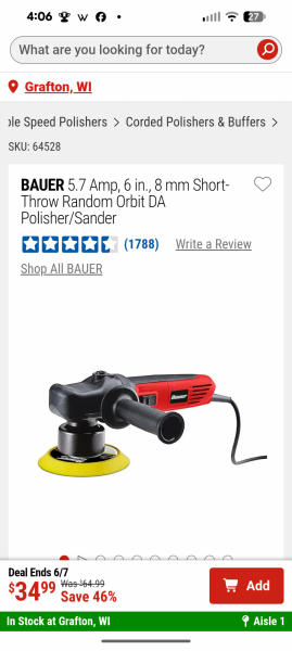

    Ok. I bought compound to buff my gelcoat on my fiberglass boat. There's a 8-10" wide black stripe on the top hull that fades and needs buffing on a 25' boat. Pretty much the rest of the boat is white and looks great. Which DA buffer should I buy? I hear good things about the harbor freight buffers especially for not pro/ daily use.
    They have a couple different models.
    5.7 Amp, 6 in., 8 mm Short-Throw Random Orbit DA Polisher/Sander https://share.google/ouOy4jcn5kUveBTfZ

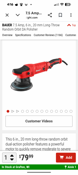

    And then. 7.5 Amp, 6 in., 20 mm Long-Throw Random Orbit DA Polisher
    https://share.google/nrN4HE4RjFDiH09oL
    Will the 5.7 amp one be up to the task? Or should I spring the extra $$ for the 7.5 amp one? It's a 6" buffing head in the kit I bought.

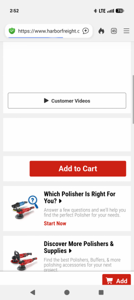

    For some reason harbor freight website doesn't fully load for me but it looks like they have a link to an answer for you question?
    Horkn and T.Jeff Veal like this.

    Hmm. Here's the 5.7 amp ",short throw" one that's on sale thru tomorrow
    https://www.harborfreight.com/57-amp-6-in-8-mm-short-throw-random-orbit-da-polishersander-64528.html

    7.5 Amp, 6 in., 20 mm Long-Throw Random Orbit DA Polisher https://share.google/DAjB1f4OLK97bPSYM
    What's the difference between the ⁶ and 20 mm stroke as far as polishing

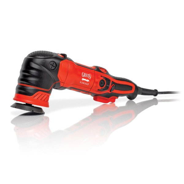

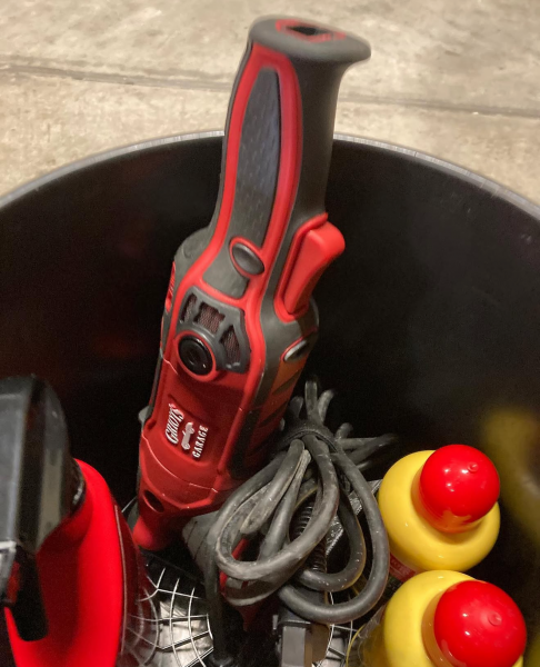

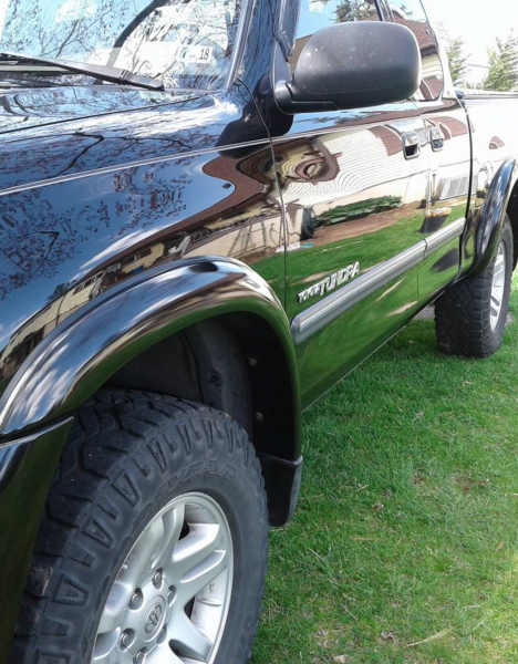

    I really like my Griots. I have the G9.
    The shop I work at now has a guy that runs a detail business there. He has several brands, I’ve tried em and let me tell you.. (just my .02, not trying to be disrespectful to anyone), the horror freight ones aren’t closely compared to a “good” brand premium one. Night and day difference. If you’re only going to use it once, every 3-4 years then I can see getting the cheapest one possible. He never used the Griots and liked it enough to order the 3&4” one for small radius and motorcycles. Haven’t tried it yet but I sure will soon.
    The G9 is one that if you push too hard, it will not continue to cut. The 21 I believe keeps going no matter how hard you push. Being it was my first foray into random orbitals, I went conservative and I’m still completely satisfied.

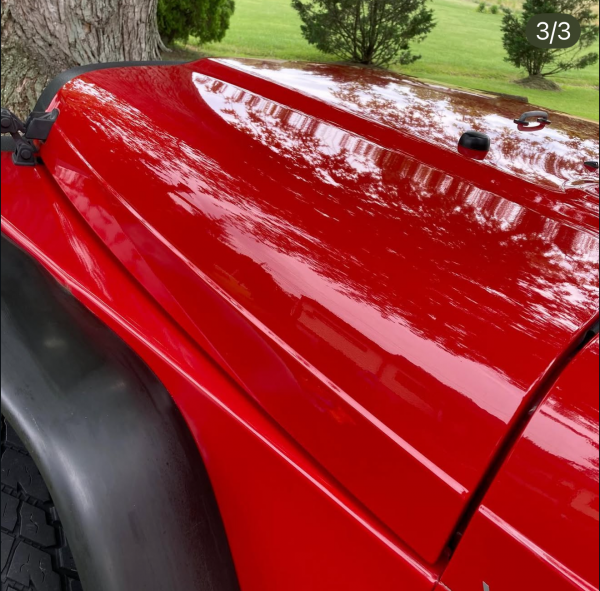

    Couple random pics of our vehicles that I’ve done. Their products work well too.
    Blue CRV
    Buy once cry once. I’m at a point in my life where I can’t tolerate crappy cheap tools.

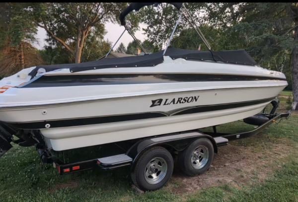

    While I like buying quality tools, this is such a small bit of gelcoat that needs to be freshened up. It's just the top black stripe on both sides. The bottom stripes are fine. 68170d41-f1ed-4ff5-a126-a66e3e9ee82b-54662dbf-cd2f-4932-a401-e2e416f6e817~2.jpg
    I'll buy the one that's on sale and I'll see how it works out.

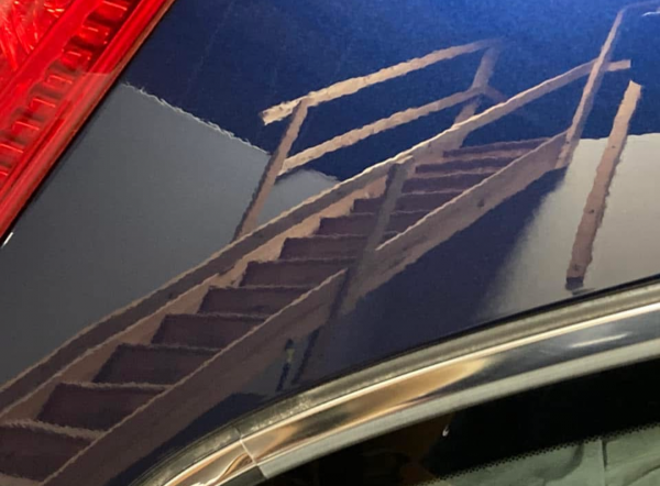

    Blue Firehawk....
    German Menzerna polishes
    My factory paint doesn't have much for orange peel, you can see some in the OEM paint on your CRV. Nothing you can do about that other than block sand it and then polish it back out. That's a lot of work though and you risk the chance of sanding through the clearcoat. LOL
