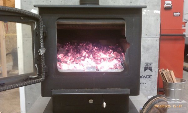

  7. oldspark
    oldspark
    Jan 2, 2014
    2,534
    7,444
    NW Iowa
  8. oldspark
    oldspark
    Jan 2, 2014
    2,534
    7,444
    NW Iowa
    I hope it's OK to post that picture as it's not mine.
    TurboDiesel likes this.
  9. bobdog2o02
    bobdog2o02
    Nov 19, 2015
    3,010
    10,445
    Drury Lane, PA
    If your not getting enough heat from that stove full of coals with air WOT you need a bigger stove and better insulation. Period, the problem is not the coaling, its the stove size// BTW i bet that pic was taken during the "vortex" my BK with cat and auto stat made a belly full of loals like that numerous times last year. It happens, its not a design flaw, it just happens.

    Now you are getting it but part of the point is the non cat EPA stoves are more apt to do this.

    I had alot of coaling today too. I was burning fence posts. I think it must have been hedge. Intense heat off a small load and coaling somewhat like the picture above. I open the air control to burn it down. Burned a really long time for a small load and very hot. Was definitely not pine.
