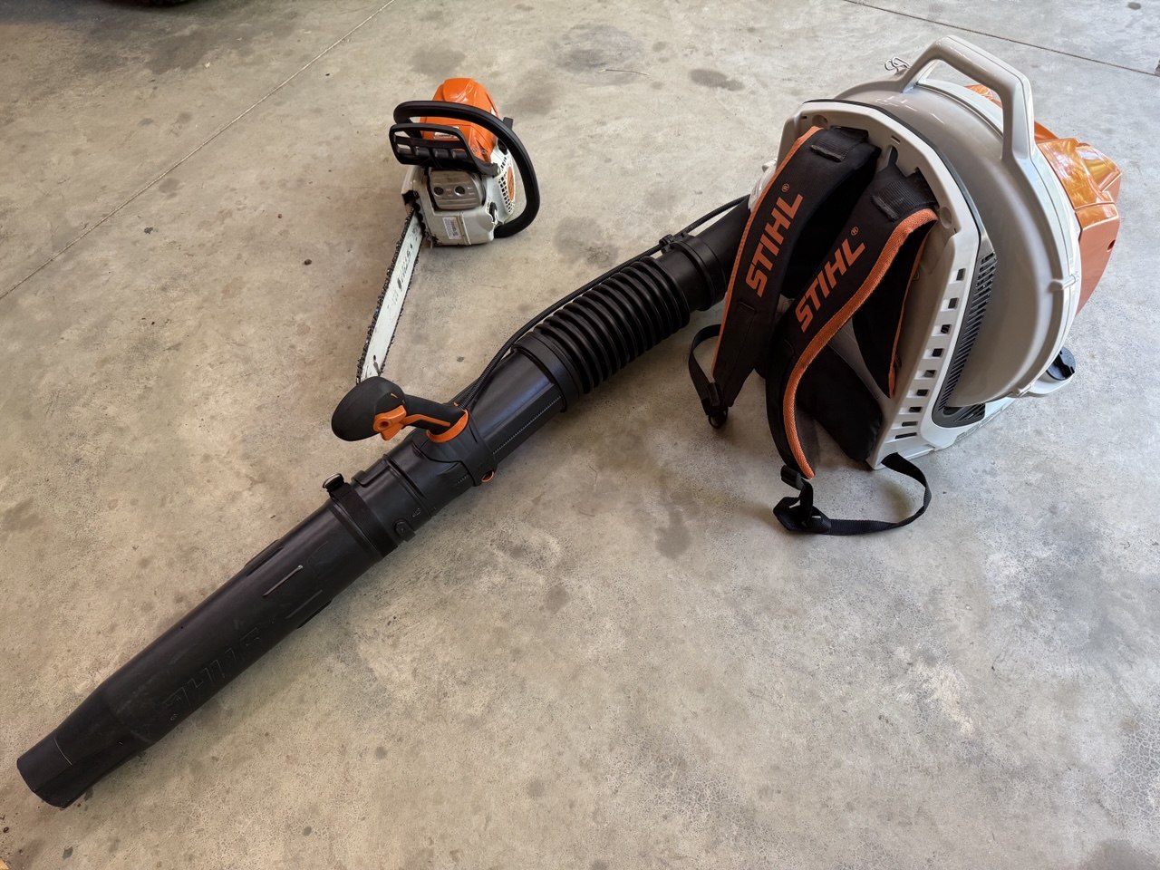

    Preparing for sale.
    Look how abused that poor blower was lol.

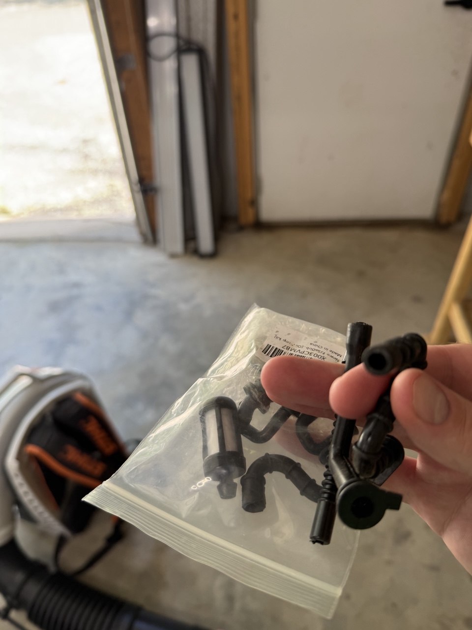

    Also this is just the random lines and grommets I pulled out of a box. Who knows, I probably already had the necessary part lol.

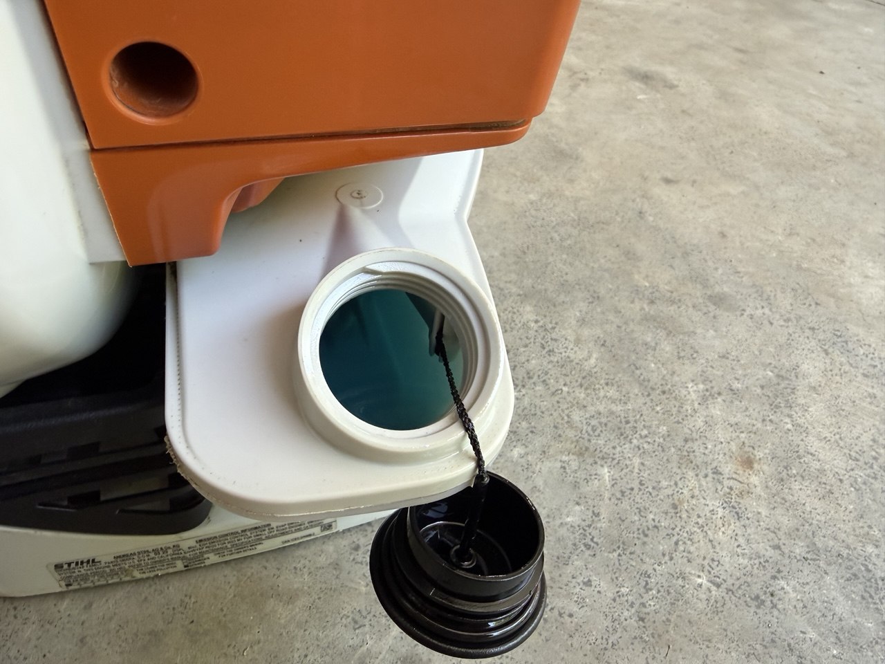

    UPDATE UPDATE UPDATE
    Stihl took mercy on me and swapped out the blower with a new unit. But before that they warned me that the tech concluded I was using bad fuel. I told the rep in no uncertain terms that was a load of crap.
    Anyway, got the new blower, tank was totally clear so they didn't test this unit. Oh well. But I added the _same batch_ of fuel as was in the other blower and ran it. Fired right up and ran it up to operating temp for a while and the new blower works totally fine.
