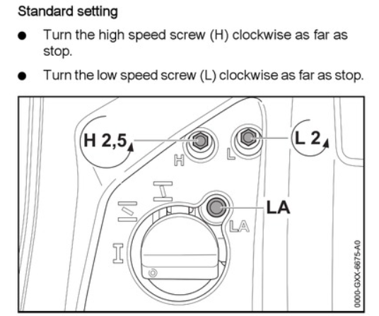

    My br800 died on me today.....right after I walked a quarter mile of driveway dropping branches with my pruner.
    Ran fine for 20 minutes or so like normal and then suddenly started bogging hard, getting worse and worse. Took it back to the garage and had a tinker. YT said valves are an issue on these. Had to modify a feeler gauge to check the valve adjustment and it was WAY out. Like 30-40 thou when the spec is 10. I only have twenty hours on this thing so it had to have been set way wrong from the factory. Not a good start. Pulled the spark plug and it was black black black. Cleaned it up and put everything back together since there are no carb adjustments on this thing.
    Same problem. What else should I check? I do not suspect fuel or fuel contamination; I'm running fresh Rec.90 with husqy 2-stroke mix. My saws are running the fuel fine.
    Filter is due for a change but does not appear clogged.
    And how do I get the limiter caps off the carb? They are just little pins not like what I'm seeing on YT.

    If you can get past the limiter caps, here is the 'standard setting' for the needles.

    That's exactly what the limiter caps look like. little hex head pin thinggies.
