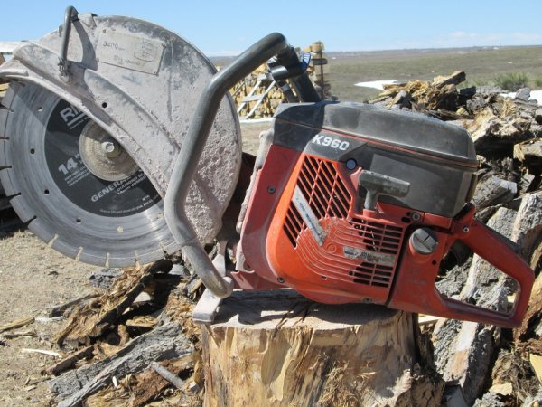

    Made some test cuts with the K960 today. I cut some concrete pavers I have for stacking wood on in half. I must say I am impressed with the saw.

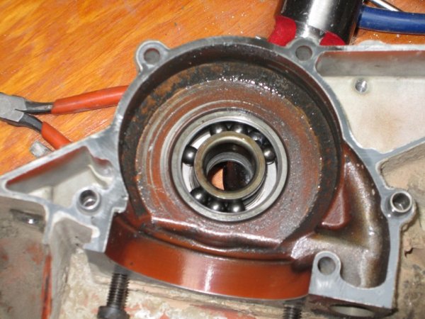

    This was the PTO side crank bearing when I tore it down.
  4. DexterDay
    DexterDay Administrator
    12,411
    31,637
    Northeast Oh
    Dislike.. Ouch!!

    Looks like a beast.

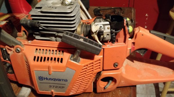

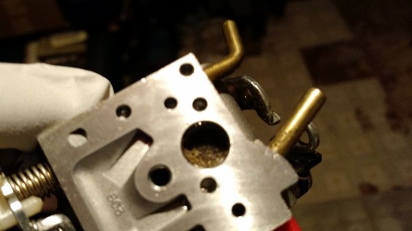

    Minty 371xp I traded for. Ran 2 tanks of fuel and things started acting up... shut her down and easy fix.
    Previous owner informed me he had local shop repair fuel starvation issues.... I believe him had receipts and was a good guy to deal with. Problem is, the shop forgot to install something :whistle:

    Don't put that screen in and you plug up with saw dust pretty quick!!! If you have the screen you only last a bit longer till you lean out still.
    Had a Poulan that was packed with sawdust like that that leaned out till I found The gunk.
    Horkn and mdavlee like this.
