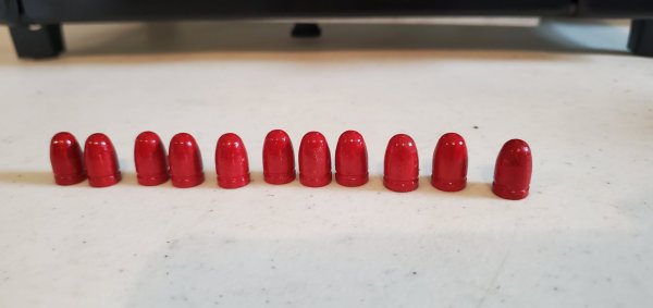

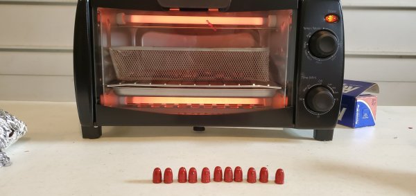

    Finally getting around to it. Ammo had been so plentiful and cheap, it got pushed to the back burner. Powder coating some 125gr 9mm today. Not too bad, simple is easier and does a decent job.
    -Pre-heat at 350 for 2 min.
    -Shake in plastic container til coated
    -Pour coated bullets through sifter to reclaim extra PC.
    -Pour bullets into makeshift (office organizer) basket, unlined, directly into toaster oven at 375 for 15 mins.
    -Let cool for a minute then dump onto aluminum sheet on garage floor.
    -Let cool, put into stash

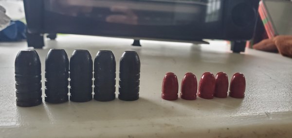

    45-70 405gr left
    9mm 124gr right

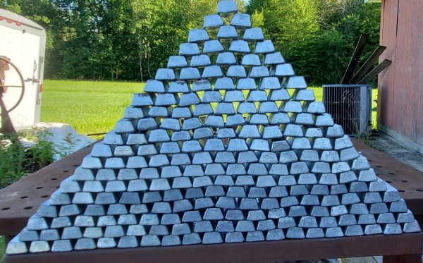

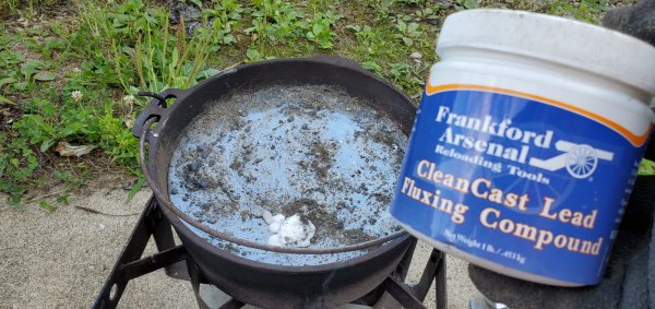

    Melting down a ton,(1/2 ton) of roof flashing into ingots. It's best to do this when lead is bone dry. Anyone who have had a steam explosion can testify to that. Lots of oxidation on this stuff, I only do this outside with a barn fan behind me to keep fumes and lead dust away. These ingots will be cast into bullets over the winter.
