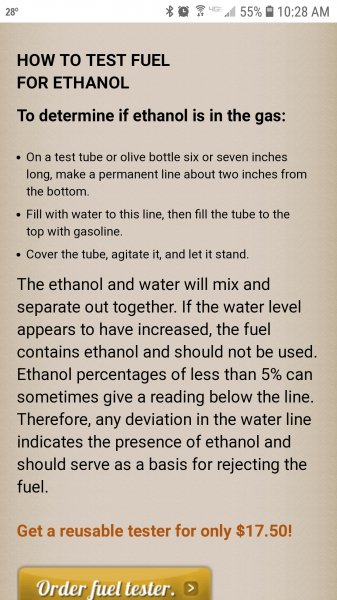

    Pennzoil for air cooled engines. Used it when I flew a couple hundred hours a year with a Rotax or Hirth powering a CGS Hawk. Greensky Adventures was always impressed with internals during the scheduled tear downs of the engines.
    I always ran ethanol free (tested with the olive jar trick) or avgas in ultralights. Rotax had issues with carb boots being chewed up with ethanol. We had a Rotax 582 seize in flight at Sun-n-Fun while being flown by a reporter, with only 30 hrs on both engine and air frame. This was due to a cracked carb boot sucking air. Farmer let us keep the plane in his field until Lockwood Aviation could rebuild the motor, which they did over night at the show. The fact the reporter had the seizure and Lockwood was a large U.S. distributor for Rotax was a major reason Rotax upgraded the boots as quick as they did.
    I literally trusted my life with that stuff and it served myself and others well. I figure it's good enough for my saws and I use an old Stihl 028 Super AV as a primary.

    Olive jar trick??? Care to explain, never heard of it
  7. Casper
    Casper
    Jan 25, 2017
    1,710
    9,667
