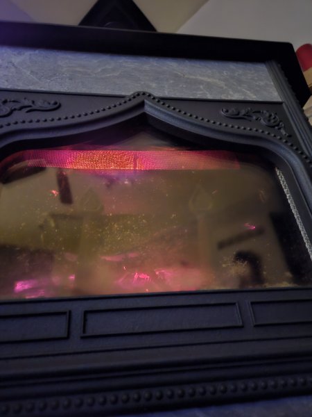

    Hmmmm? Failed to read anywhere in this extensive discussion about the life of combustors in relation to how they are cared for and operated. I lot of variables can change life dependency quite a bit. Type of fuel, moisture content, burn rate, cleaning, etc. Attached is a picture that I took yesterday of our 6 year old Woodstock steel unit. Should have wiped off the glass for clarity. Just fly ash. I only brush off fly ash every few burns and clean it thoroughly before every burn season. No complaints as it still is working ok. To each his own!

    Your cat looks hot in that photo but "years" of cat life is a very poor way to quantify anything. See, a cat can last 100 years if you never use it. One fire per year and it will look great after 10 years. No, the correct way to define the age of a catalyst is by hours of active catalytic activity. I use my stove every day for about 9 months per year but not everybody does that.
    Definitely don't replace a cat until it dies. My cats need to be replaced after about 12,000 hours which I usually do in 2-3 years.
    I believe that the burn rate has more to do with cat life than any cleaning regimen. Clogging with ash is a different problem.

    Common sense should relate combustor life with hours of use. No way to deny that fact, but performance related to what one burns is also obvious. Other than that, you are spot on!
