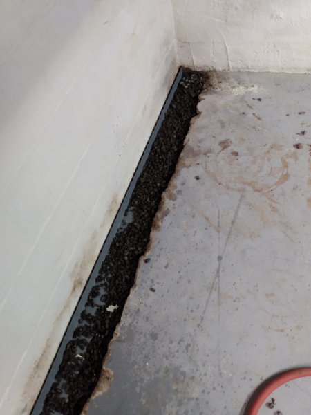

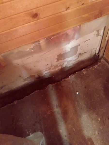

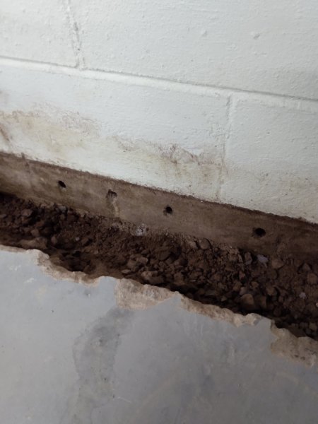

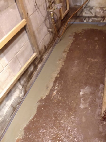

    After jackhammering a trench and cleanup/haul out of that mess, the floor was water sprayed and squeegeed into the trench.

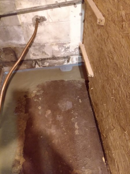

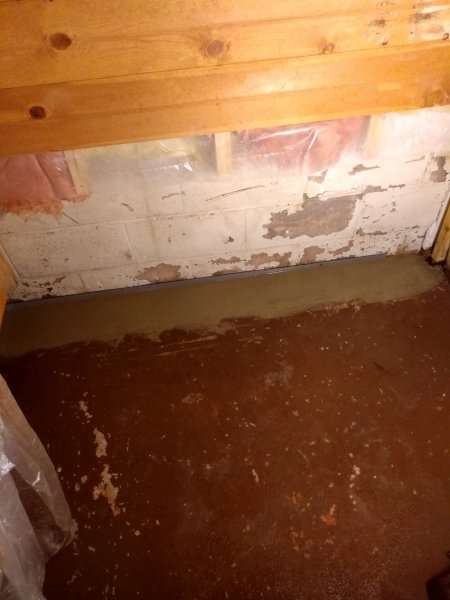

    You can see in one pic where they drill holes into the base of the block allowing the trapped water to drain. (pics #2 and #3 show mud forming due to this draining water that was trapped).
    The trench is then flattened out and watergaurd/fill rock is added to keep watergaurd at desired level.

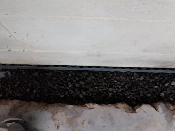

    More rock is added to top of watergaurd and the all covered with a plastic type sheet. I believe that this sheet prevents the concrete from "seeping" down through the rock and into the watergaurd.
    You can also see the space between the watergaurd and the block wall. It is designed this way to allow to capture any moisture that may form on the exposed block wall a place to drain away.

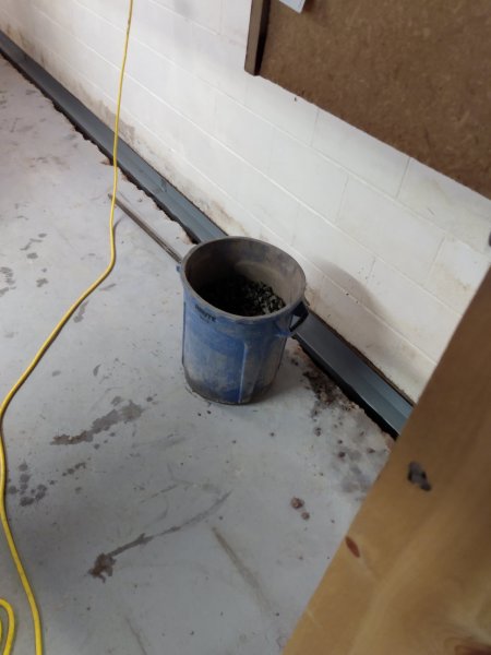

    Pic #1 shows open trench drain in front of door. Probably a winter project..... make a new door? ;)
    There are two access ports in the water gaurd. These can be used for cleaning/flushing the system or even de-humidifier discharge hose drain access. But....... like I told the salesman, if it works right, I won't need a de-humidifier...right? :smoke:
