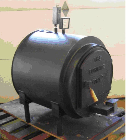

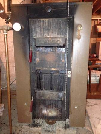

    The Pig would burn one of these loads per year.

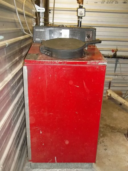

    The Tasso about half of the load !

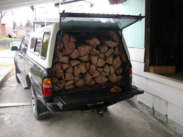

    The Jetstream burns 8 t0 9 Toyota pickup loads per year supplying the same load .

    The firebox in most cases is surrounded by water, making for a very low combustion temperature, and add green wood you have lots of smoke. The pig in the picture above is much like today's OWB without the pretty little house around it. The drafts are on or off. Once the water is up to temperature, they have to shut down or they start producing steam.
