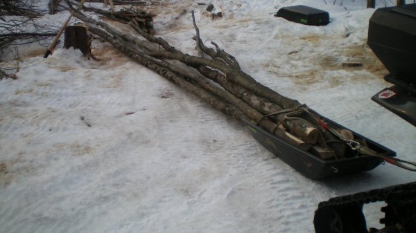

    I usually cut down to 2". Because I slide logs out on snow, I trim the branches nice and clean to the main trunk. I'll then trim all branches down to decent small poles to haul out in a bundle. Here's a bundle of poles ready to haul out...

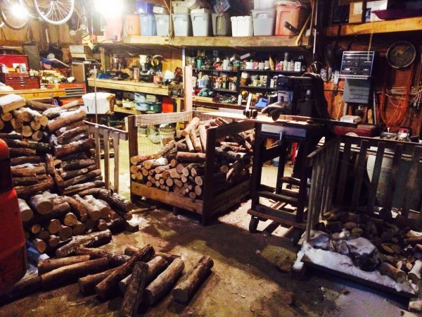

    So I finally broke down and did it last weekend, since I literally ran out of anything short enough to fit in the Answer. What you're seeing in the picture, besides my messy shop, is a re-purposed Monkey-Wards radial arm saw in the middle with a c-clamp stop on the rail set at 17", the theoretical maximum that will fit in the stove. On the far left is a previous loaded bin of all lengths. Next to that and directly to the left of the saw is the bin for newly cut 17" pieces and the bin to the right of the saw is for off-cuts. The pieces on the floor are the ones too large to be cut on the radial arm. I'm cooking up a jig to mount my electric chainsaw on a pivot so I can hold the piece in a v-shaped saw buck while it's being cut. The only saving grace of the situation is that I was able to do the task indoors and there was already quite a few pieces that were short enough but just needed to be sorted through.

    That's as good as it gets and it's inside... :yes:

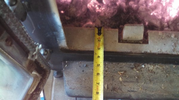

    18 would work, but the front lip is just about 3".
    You know, I just remeasured and the 20" is to the lip, then there's another 3" of lip, although when I put the tape all the way to the back, I came up with 22.5.
    Must be the tape shrinking from the heat.:headbang:
    Anyway, if you take the bricks out, the internals are just a little more than 3.5 cu. ft., but I don't recommend running the stove w/o the bricks.
    So, the usable space is still just around 2.75.
    ETA: Forgot to add a pic......
