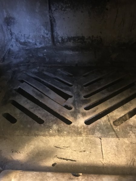

    I am not sure how this happened but the ash grate broke in two spots! The odd thing is that I never noticed until the other night. We haven’t over fires the stove that I remember :loco: :crazy:
    This has been a superb stove for us I’m very disappointed right now.
    O well we got ahold of the stove shop and they are on it.

    Does that lift out? Looks like it sits on a ledge.

    Looks like she got hot. Any chance of an ash pan air leak?

    Yes it lifts out easily
    I’m wondering about that myself.... We haven’t used the ash pan I years it gets opened once a year specifically to inspect the stove and then I ignore it. The ash pan works good but honestly it’s harder to use the pan than scoop one scoop before each load...

    I remember those days of burning with a stove that had grates. Just a matter of time with the fire built right on them. Last time it happened, I had a local welding shop fab up a set of grates...just out of round stock and they worked fine.

    I may take your advice Dave I’ll probably weld this one after the new arrives to replace it.
