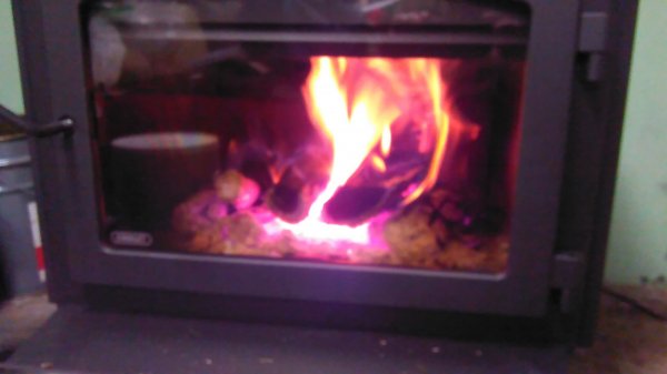

  14. Sinngetreu
    Sinngetreu
    Mar 15, 2014
    1,235
    3,945
    North Central Iowa
    Second fire. Medium fire. Almost up to a good temp.

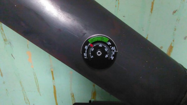

  19. Sinngetreu
    Sinngetreu
    Mar 15, 2014
    1,235
    3,945
    North Central Iowa
    I did however buy a spot light and mirror so I can keep an eye on the chimney. It will also help me get a good gauge on my sweeping. Works and looks pretty good.
