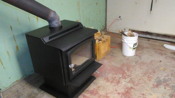

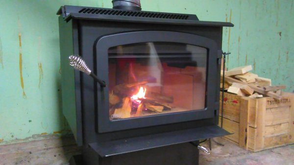

    I'm a little pooped for actual data, but here are some pictures. Just doing a few small fires tonight to cure the finish.
    Before I got the stove installed, I cleaned the pipes and chimney really good with my new Soot Eater (which surpassed my expectations.) and re-fit the pipes to fit.
    Here is a picture of the first burn of the season as well as the first burn of the stove.
    So glad to finally have it here and installed.

    nice install, do you have a key damper in the pipe?

    Thanks. I do not have a key damper in the pipe. Do you think it will need one?

    Hard to say not knowing some specifics. If you find it’s hard to slow the stove down a damper could help.

    Refresh our memory. What is the vent sys comprised of? Single wall from the collar to the masonry chimney or? Liner? How many feet from the thimble to the termination?

    Single wall to the masonry chimney (terra lined). It's in the basement and goes through two floors and the attic. I estimated it at just over 35 feet or so.
    I used 12 sooteater rods (3 FT) and just made it to the top without going past.
    That was probably one of the most effective cleans I have been able to do.

    o_O 35 feet..... What is the inside dimension's of the terra? If you can dial the stove down to a almost zero lazy flame after establishing a strong initial fire you should be ok. If not. Install the damper. Your new stove ushered in the correct weather! Load that puppy up and get us a performance/controllability update!

    A damper would be cheap fail safe

    The inside of the brick is 12 by 10 and the terra would bring it in the thickness of the tile. I can't get to that right now.
    Whats interesting about this location is that sometimes the draft is over powering and sometimes its little. I have never not had draft though.
    I think I'm going to run with it until I get a good baseline on the new stove. My old one was an EPA exempt one and was hard to control.
