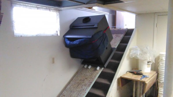

    Well, we got it in the basement.
    I'm not very good at taking pictures, but the general way it went was we slid it off the semi trailer onto a snowmobile trailer on a scaffolding plank. Then we drove it to the house and took it off the trailer to the landing in the house and down the stairs.
    The below picture is while it was half way down the stairs. We used the scaffolding as a ramp and some UHMW "skis" to slide it on. We used a come along to lower it down slowly, but ran out of cable half way down so we had to handle it from there, but since we were able to stand on the floor and not the stairs, it was just a matter of helping it along without tripping on anything.

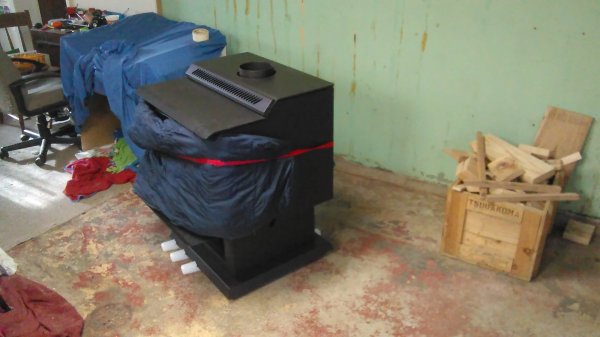

    And finally a picture proving we made it to the ground in one piece.
    Now we have the task of putting it all together. At this point, I'm super thankful that the stove is in the basement and my back came out ok.

    Getting it where it needs to go is a big accomplishment, those suckers are heavy. Glad it's in the basement safe and your back is still working...........:yes:

    I will.
    Those skis were really helpful. If you have any way of making or getting something like that, I would say "do it". Let me know if you need details.

    It feels good knowing that it can't fall any more. :rofl: :lol:
