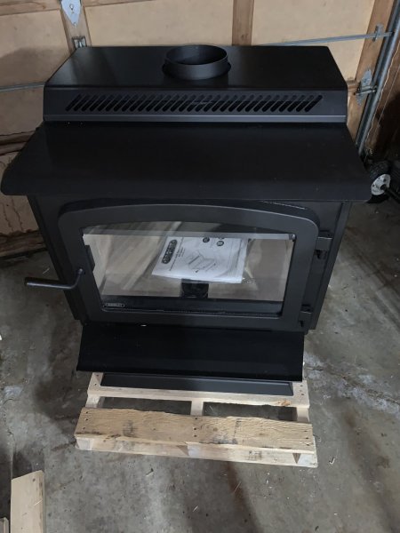

    Much better construction than the summers beat! Now I just gotta find some friends to get it in place. People seemed to stop answering calls 3 or 4 stoves ago...

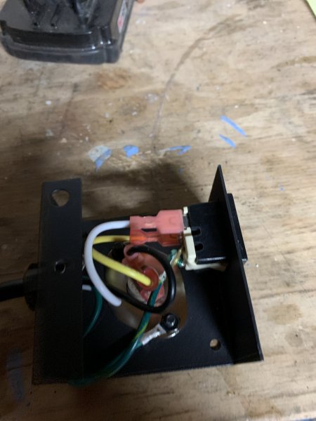

    Sinngetreu . I took the cover off the fan switch the other day I think I was wrong about not being able to make something work for 60 bucks. A short piece of extension cord, thermal switch and outlet is all you would need. All of that could defiantly be hidden behind the stove.

    Honestly, that's kind of what I was thinking after I saw the price of the switch. It may not be tidy and pretty, but it might get the job done. Thanks for the confirmation on that.
    Is there anything else that the wiring goes through, or is it a direct link to the switch and direct out?

    The outlet is directly direct to the outlet with one of the circuits switched by the snap disk. image.jpg

    Sorry the extension cord Is direct to the outlet. The snap disc interrupts the live circuit.

    Funny thing is, I knew what you meant. The picture did help though.
