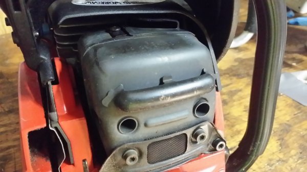

    BTW- Nice saw WVhunter
    The muff mod is a must. I can take a pic of mine tomorrow if you'd like. Very easy to do and accommodates a screen without hardly any work. :)

  2. Eric VW

    Yep, thanks Dex. I would like to see that.

    Cut an equal sized hole in the muffler and in the front bracket. Then place a piece of screen between the two and remount :)
    Easy Peasy!!

    Nice job Dex! :yes:
