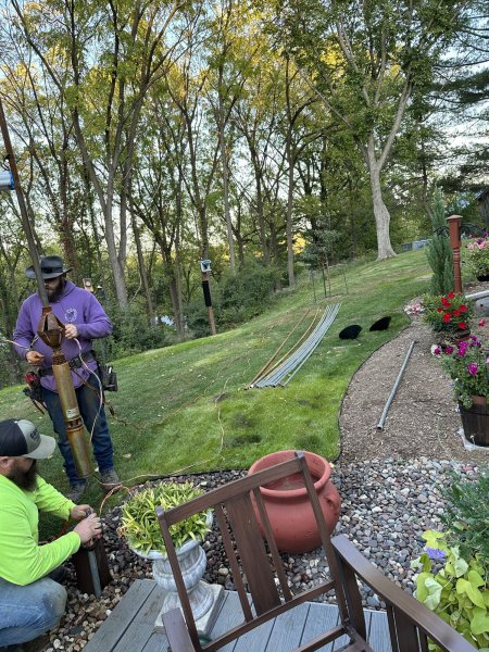

    Exact same thing happened to us a couple weeks ago. The well guy’s truck had a fitting that could grab and pull out the pump. It looked like a very specific piece of equipment.
    FWIW prior owner here was a DIY guy and did the pump, or some kind of well work, himself. He ended up contaminating the well so it didn’t pass inspection. We had to have the well sanitized and re-tested when we moved in, which was inconvenient and not exactly cheap.
    I’d leave this one to the pros.

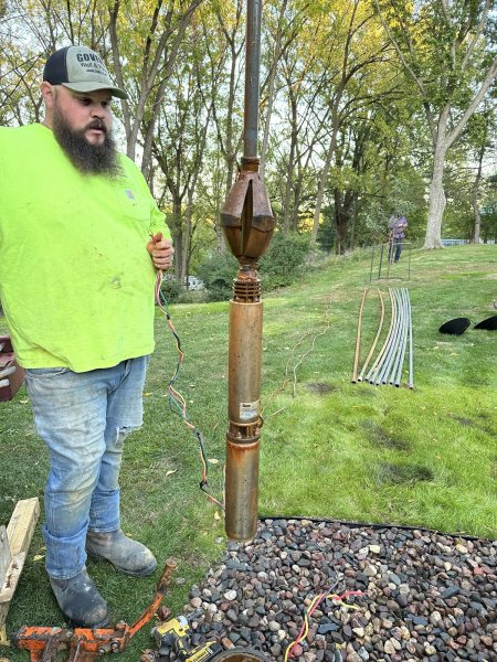

    A little late here, but for posterity, this was the thing/process. Cost us $700 plus change.

    I've pulled some 400' wells (poly pipe) the hard way (with help of course) and I would NOT try a 200ft pull of galvi by myself without special equipment.
    My last home (in NY) needed the well pump replaced in 2016(ish), was about $2,100 for a 250ft pull, new wiring, reused the poly, went back with a 1 HP pump (replaced a 1/2HP). Guys showed up at 8am and were done by 10:30. Galvi pipe would have slowed things down a bit.
