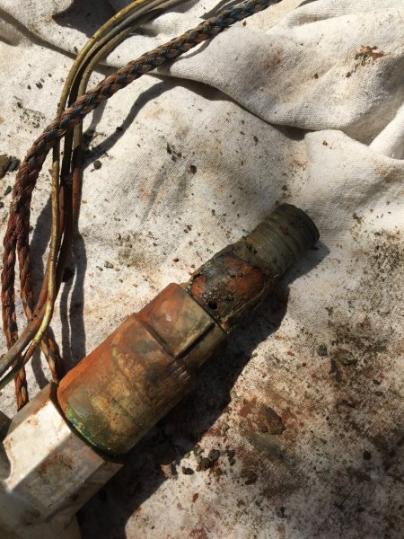

    Found the culprit small hole on the barbed adapter into the foot valve of course the remainder of the fitting crumbled but I bought new check valve. You'd think lowes would carry an 1-1/4" close nipple but no so sent another small piece of galvanized down hole to fail in 10yrs

    Sad to report the galvanized nipple I used to attach pump to foot valve failed last night- just 2yrs in service. This time below the foot the pump was running continuously and not building more than 30psi.
    Of course no one had an SS or brass nipple so another galvanized nipple is in took me 2.5 hrs including trip to ACE. Ordering an SS nipple from McMaster Tomorrow to stick in the shop for 2 years from now.
