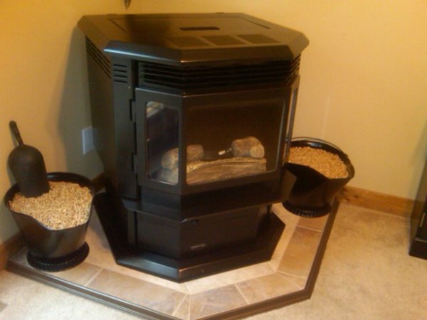

    Pre made pads can be had for cheap on CL? If you look, you may find one. Look nicer than the black metal mat HD will sell you. I have had 2 of them. The 1st I paid over $400 for (Quad/old install/42" corner board), the 2nd was free with the purchase of a very cheap stove. It doesn't have as nice of Trim, or have 2 tone coloring, but it's a 48" corner pad. So it allowed me to have more from for Maintenance.
