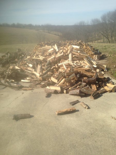

    That little pile in front of of the ash there. That's all I have left for this season and it's not seasoned enough so thankfully we in warmer weather now so I've been burning the pellet stove
