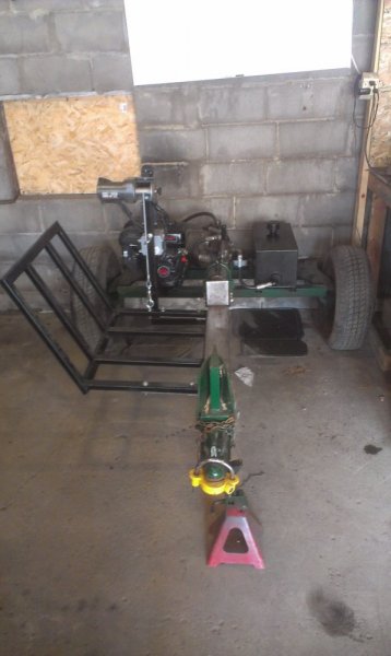

    Well here is the final product! I sprayed the terminals on the winch with liquid tape to keep them clean from the elements as well as the cable ends to seal them from corrosion. The switch is mounted on the top of the pole and I cut about 7' of cable off it and re wired the whole thing with the ignition wire to the hot so it works without a key. I decided to keep the remote box in case but it will probably never get used lol. The grey box is an out door wiring box that the battery wires are wound up and stored insider of to keep them clean as well. I left just enough cable on the winch to lift and lower the table so it runs faster ( which it does! ) and then I found some wire looms from my engine swap so I cleaned them up and put them over as much of the wire as I could then zipped them on.

    Hey Pete, looks great. I see you decided not to use the winch to haul big pcs to the lift tray? (short cable)

    After I used the winch I realized just how light duty the winch is so I decided to not wear it out pulling long loads. A short burst up and down will make it last far longer. The nice part is the which comes apart easily so I can grease the gears every now and then.

    Ok fellas here is the complete job minus new wheel wells and a battery box. The wheel wells are in a few weeks and I found an old metal tool box I'll probably add for the battery to set in when I'm not towing it around.

    Yeah Buddy :thumbs: now you'll be workin smarter not harder

    Great job man. Sure beats manhandling things.

    I think it turned out great!
    Turning exercise equipment into non exercise equipment is always a good thing! :yes:
