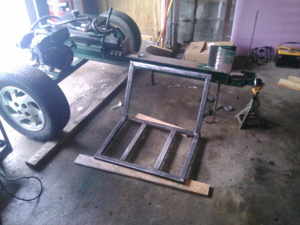

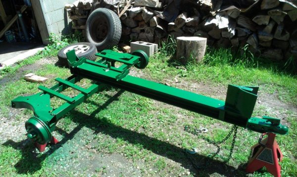

    Well I FINALLY got time to get back at it today and welded the bottom supports in. The new welder is awesome! It makes the old one look like crap and did in one pass what would have been two on the old 115 machine.:thumbs: The dirt is from me jumping up and down on it to be sure its not gonna break. Ya I am that anal.:emb:

    Are those aluminum wheels on your splitter?? Looks awesome Pete!!

    Yes it is an old Nissan rear end so it even has the brake drums in there still.:thumbs:

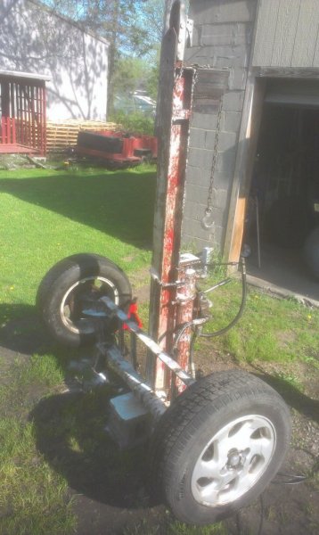

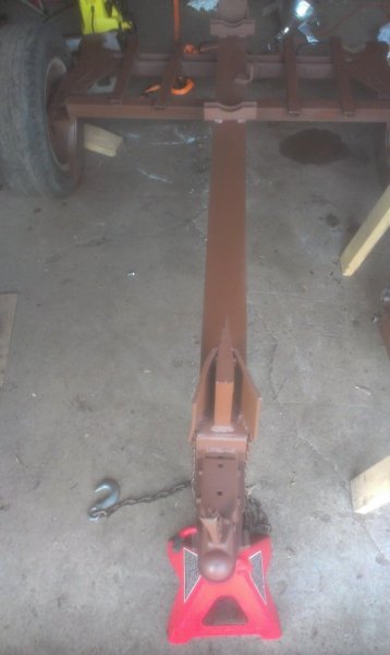

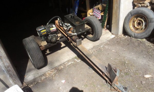

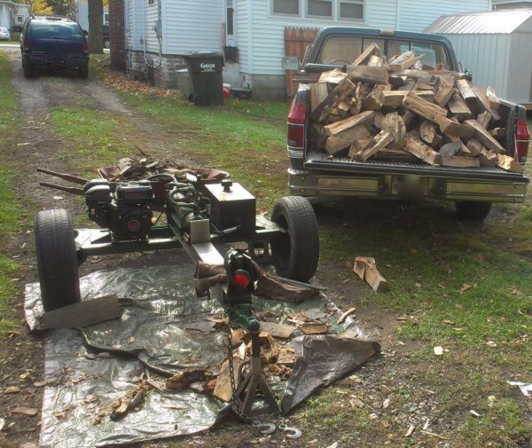

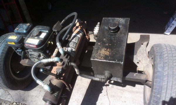

    As you can see its still a work in progress. I can't wait to finish the lift up.:drunk:I bought a new HF212cc motor as well two pulls and away she goes every time. The frame and I had a meeting with a very nice wire wheel I won that battle.:D Rusty metal primer and 3 coats oh catalyzed tractor paint and it is green now. I wheeled out the cylinder and oil tank then painted them with black catalyzed tractor paint as well. The detent valve didn't get much done other than a really good cleaning and of course all new hoses. O ya I added a new 2 stage pump as well.

    Pete are those "wings "on the wedge add ons, or were they existing?

    They where on it when I bought it from Amature Cutter I think he added them. Either way they work great!
