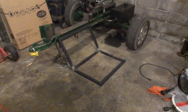

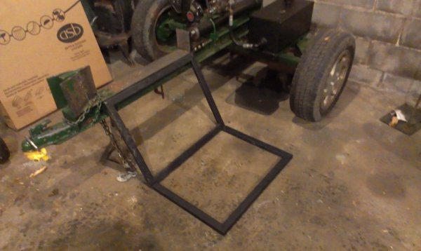

    Ok well I had enough heat to get the frame welded together.
    First pic is two halves separate that I welded together a while ago.
    Second is the two halves together with the paint stripped at the weld points.

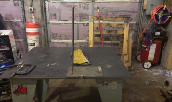

    This is an idea I had one day when I first started welding. I couldn't hold a piece upright because the magnets where not strong enough so I made this little jig. I lean whatever Im eliding at an angle on it and put a clamp on.

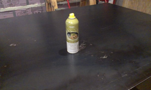

    Lastly my secret weapon against a rusty welding table.

    Paste wax works for keeping the rust off too. Both are flammable so watch out. :fire:
