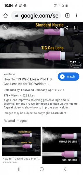

    A quick screenshot from the web. When I get back to the shop I'll take a picture of mine.

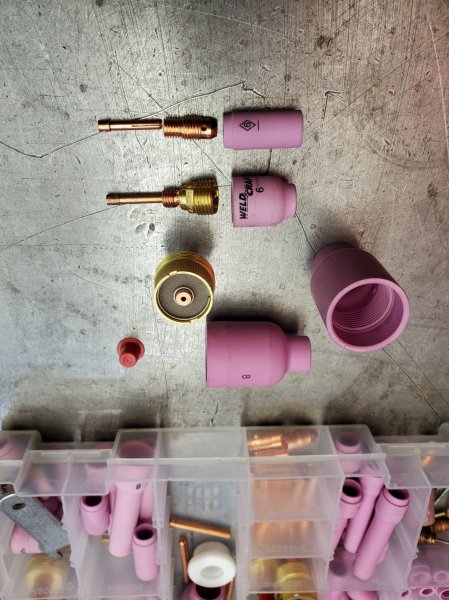

    So one is a standard cup used for Tig welding and the other because of shape and size is called a gas lens.
    The next time I am at the welding store like Air Gas I will have to check into that. I can see having a steady stream of argon flowing at the part could cut down on oxidation.
    So I was confused by the terminology thinking that a cup or nozzle used at the end of the torch was the same thing as a gas lens. Ok Thanks.

    So here's a pic I laid out showing 2 #6 cups next to each other. The top is standard and the bottom is a gas lens, but both are still the same size. The bottom one shows the diffuser with the screen stack.
    Hope this helps.
