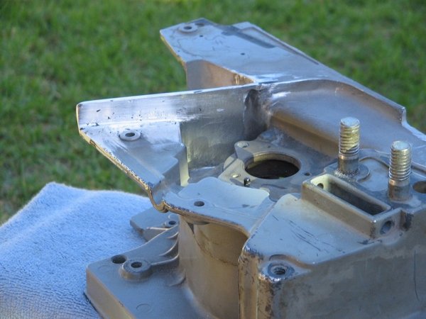

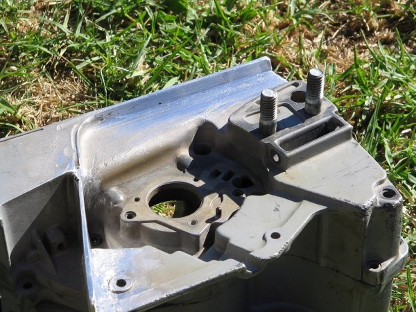

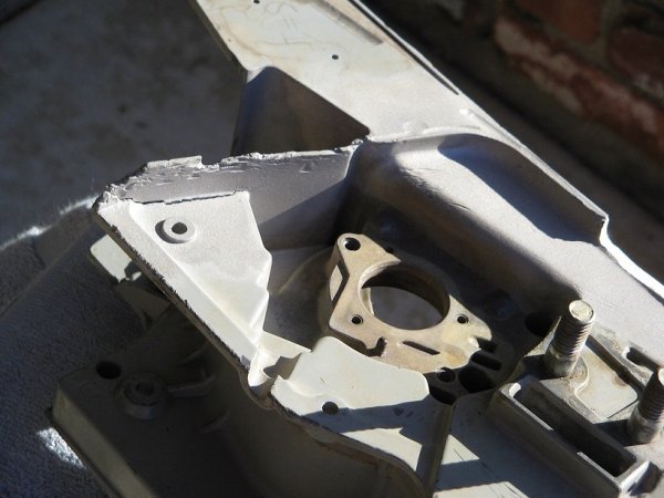

    The rod you use for welding on chainsaws is AZ92A. There is a few of use around who have done some work on chainsaws.

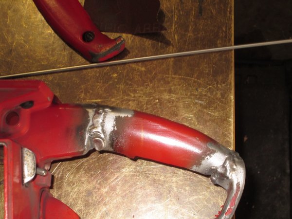

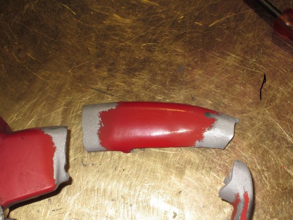

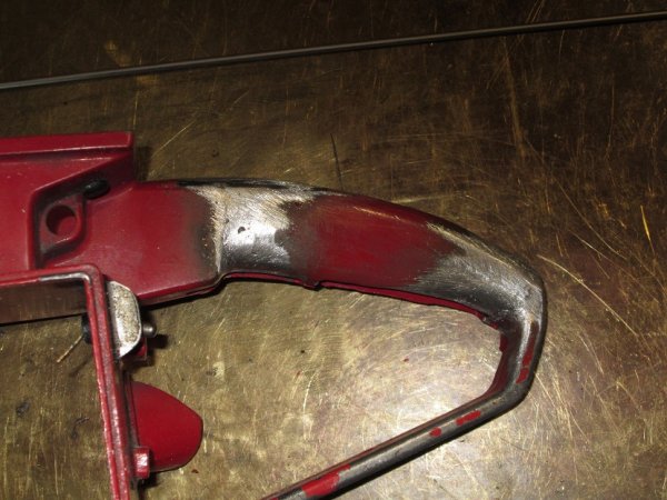

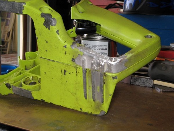

    Another project.
    Hammy, Thor, unclefess and 10 others like this.

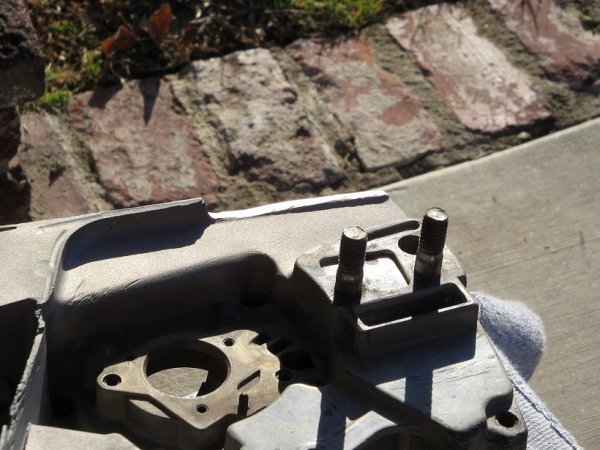

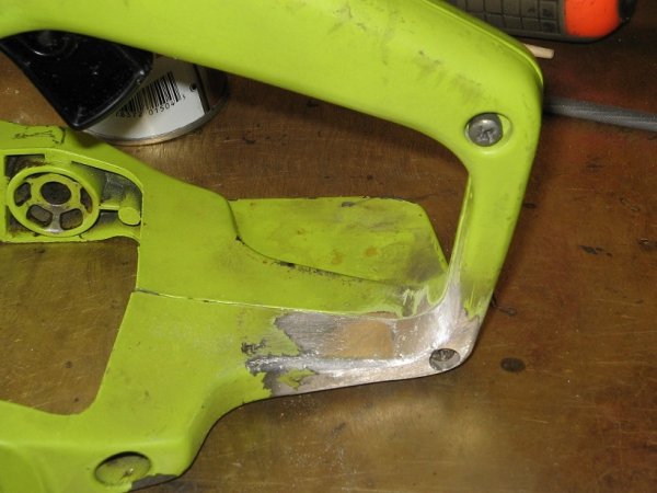

    One more this one is on a old Homelite using AZ92A mag rod.
    Hammy, Thor, unclefess and 11 others like this.

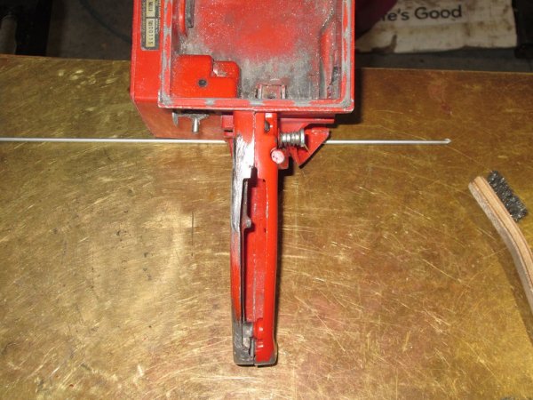

  14. Mag Craft
    Mag Craft
    Dec 15, 2014
    4,802
    27,739
    South East Wyoming
    No back gas. I set it up close to welding aluminum and use the argon gas shielding at the nozzle. You do get a lot of soot from welding on chainsaws. I do not know if it is from the casting itself or because of all the oil that chainsaws are exposed to. I always sand blast first which does help cut down on the soot and some of the pitting.
    When I first started I practiced on a old crankcase just running beads to get used to the look of the puddle and how it flows.
    I am not a professional welder just a hobby and self taught. A lot of UTube. It just takes practice and a desire to learn.
